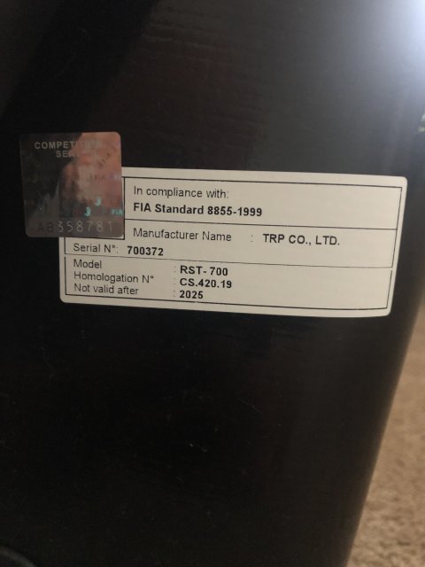

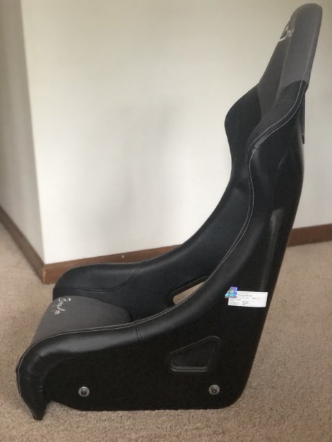

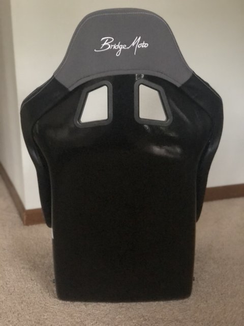

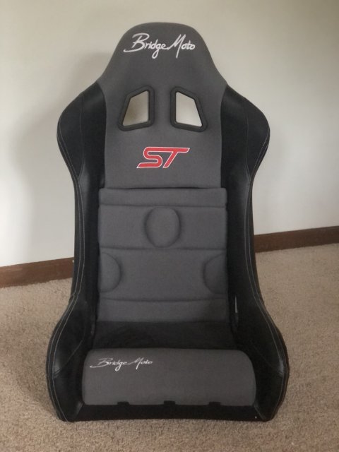

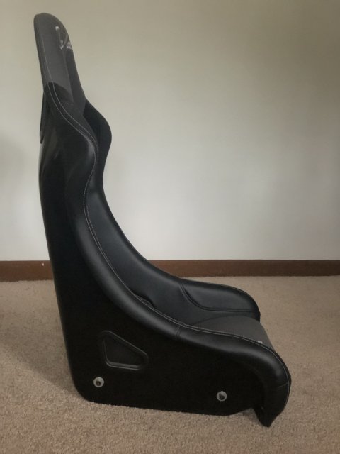

This has been sitting in my office for a few months. I love my halo seat so I don’t want to swap. I can’t decide if I want to keep this or sell it..

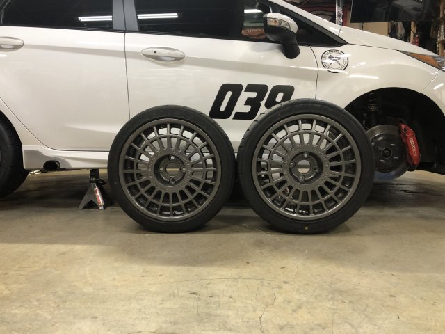

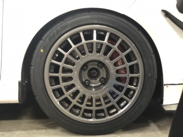

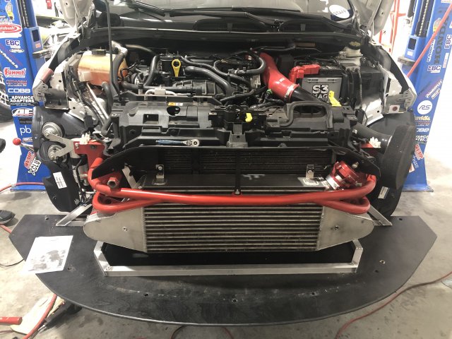

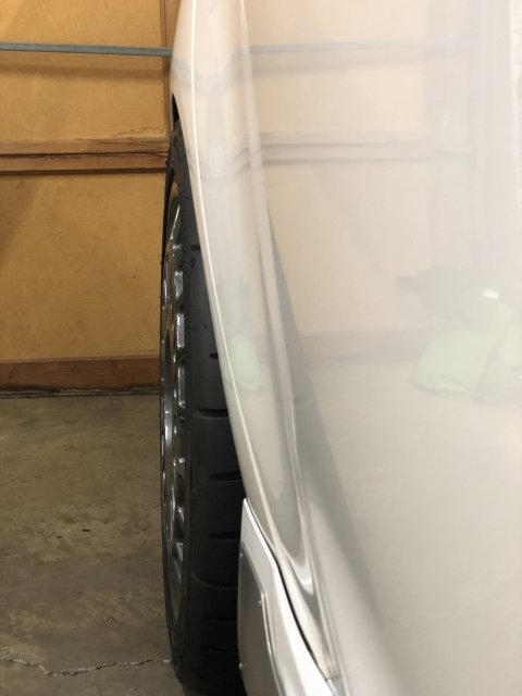

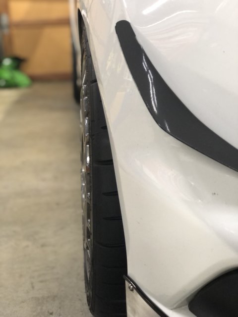

Rolling these front fenders is a pain. The front tip won’t pull out without some cutting and a lot of heat. In the end, I have to have someone clean and repaint it. After loosening the bolts and sliding the fender out then rolling and pulling as much as I could, I think I can fit 235s easily in the front. I’ll find out next week after they’re mounted to the rims. Rolling and pulling the rear doesn’t seem possible so I’ll probably just stick with 215 RT660s back there. Having a 235 up front will be much better. Hopefully this day wasn’t wasted.. Here’s a naked front pic.

I’ll post another update after I’ve had a chance to drive it. They’re tall but my car is about stock height. I’m optimistic but definitely not holding my breath.
