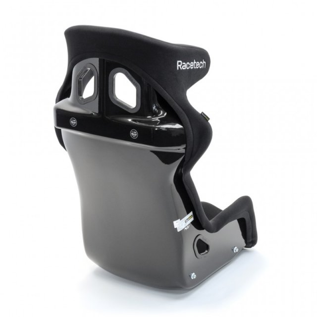

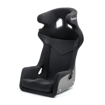

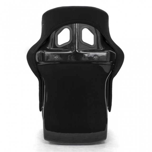

New seat is on the way. I sprung for the Racetech RT4100WTHR since it connects to the harness bar. I’m hoping it’s as cush as everyone’s telling me. Loved the OMP HTE-R but it was too short for my body. I’ll be installing my custom Bridgemoto seat on the passenger side so I can sell the OEM Recaros and OMP HTE-R to recover some cash. Here’s a few stock pics of the Racetech. Handmade in New Zealand!

The Racetech seats are BAD ASS. I have one here for my other race car. It was one similar to yours, but it was the seat homologated for the 24hr of LeMans Vipers. So back in the day Chrysler made Racetech test the seats to 45gs of impact forces. That is equivalent to the current 2009 FIA certification. Most all seats we mere mortals use are FIA1999 Homologation. They are only tested to 10gs.
Attaching the seat at the shoulders to the roll cage is a good idea. Its a solid connection to feel what the car is doing and it supports the seat back while in an impact situation.

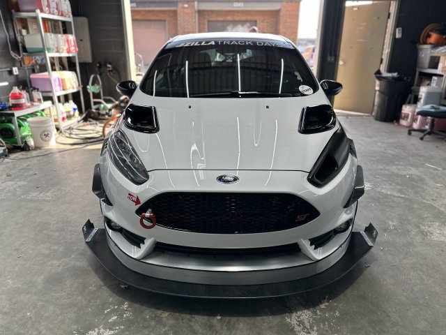

It’s 3” max and extends back to the center of the front axle. I guess I’ll build a 5” since they’re gonna class me street mod. Too bad nitrous and meth are illegal otherwise I’d just send this block for two sessions. I was gonna add splitter tunnels but need to find some fender vents to dump the air.

You are definitely into radical time attack aero territory now, albeit not as totally insane as the whole 'front wing' Pike's Peak type setups seen on the WRXes/STIs, and earlier Evos, etc.
Yours has to be one of the most furthest taken FiSTs in this country, as far as aero is concerned.

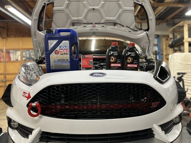

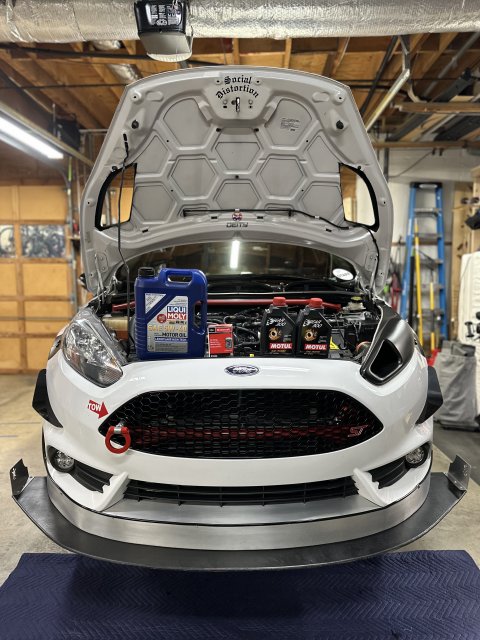

I have run LM Hightech 5w40 religiously for a few years. I think that’s the only reason my hybrid and engine are still alive. That and frequent oil changes... I sometimes use 5w30 molygen at the end of the season through winter though. My car doesn’t burn any oil but I typically have a fair amount of blow by in the catch can each change (every four to five track hours). Thankfully this is one thing I usually get for free from a buddy. It’s actually the only thing I get for free and man I’m incredibly thankful. Oil gets expensive when tracking often. The 400s filter isn’t bad though and the engine doesn’t require that much oil! Gotta love the Fiesta.
