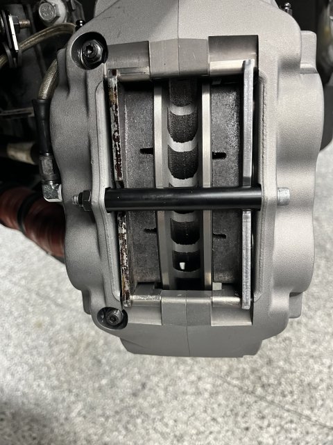

My first 2 sets of calipers from the Wilwood kit blew the seals at the track, and Wilwood replaced under warranty. The third set did fine, except for excessive pad and rotor wear.
…. which I made worse when I had custom brackets made, so that they would fit on a 11.75” rotor and allow for a 15” wheel. Got that 15” wheel on and braking ability was fine, but the heat and wear was terrible. Literally, I couldn’t make it to a third track day on new pads, whether BP-30, DTC 60/70, GLOC R18, etc.

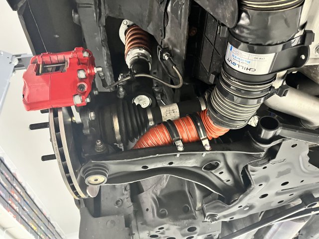

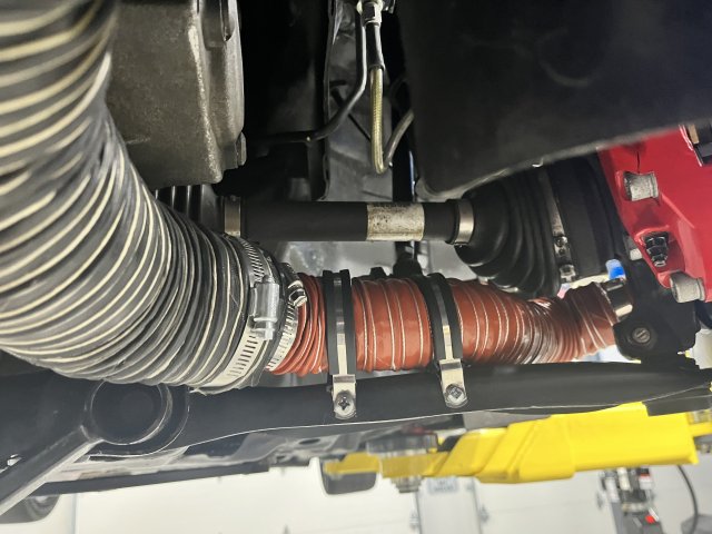

I also run ducting from the fog light area to backing plates from WOR Fabrications…. and I even have fans in those ducts on a toggle switch. 3” taken down to 2”, so that they can sneak under the axle and to the only spot the backing plate could reasonably use.

Weird. The only time I had issues was when I tried to run my BP20 street pads for a long session with no ducting or some ducting that picked up under the chin spoiler. (long before I went bonkers with the splitter and such.
What tracks are you running? Perhaps we should talk about your braking technique. :p
Pretty sure you will have enough brake now to have no issues.
I'm at 30+ HPDEs, and I've been all over the "can I do something different" angle . . . to include putting instructors back in my car to analyze my techniques. Bottom line, with R7s, track prepped car, big turbo, and driver development, I'm just exceeding the speed that brake system could reasonably handle . . . or at least that's the conclusion I keep hearing over and over from credible racers. I've got lots of photos of the rotors glowing red like the top of an electric stove, LOL.

Wilwoods melted and about killed my buddy in his FiST at Hutchinson Island years ago which is why I went with the ST40. Wheel fitment is inconvenient but I never have braking problems. I late brake like an ape and trail brake all the time and they’re always the same. I even use cheap Stoptech Street Performance pads too. They’re so effective I don’t have to run cooling ducts anymore.

Run cooling ducts, it will help with caliper life. Aluminum calipers become unhappy when the aluminum starts going above 400deg. Aluminum starts losing strength rapidly at high temperatures.

He knows how to drive. The brakes suck. Pads melted then seals melted and complete failure. He posted all about it on here somewhere.
