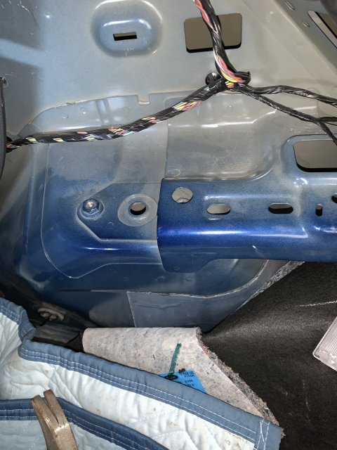

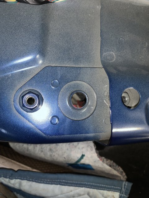

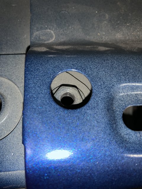

Decided to mess around with my rear suspension and in typical fashion nothing goes my way lol. So it looks like at some point I stripped one of the bolt that holds upper rear strut mount to the car. I have a welder and tools so I can fix the problem myself but was wondering if anyone has a better idea before I head into this. I was thinking of tracing the area around the mount, removing the 4 spot welds on the small piece that has the 2 bolts attached, cutting the messed up bolt off, welding a new one on and then welding the mount back in place via the spot weld holes. I'm all ears if someone has a better plan of attack. Here's some pics of what I'm working with:

Use a tap possibly?

Use a tap possibly?
Hmm, tap it out to the next size up and get a new bolt? The threads from the nut were on the bolt when I pulled it out

You could use a Bolt extender...on the Shock stud to move the threads up through the hole then use a nut with orange Threadlocker. You just have to figure out the Shock thread size.

Do you see how the would possibly work?

I think I see how that would work. Would require a longer bolt then, right?

I thought the Bolts for the mount were Built in to it. If not then yes I'd just use a longer bolt to secure the mount with Nylok nut and possibly Orange thread locker.

Gotcha. I'm going to eat some lunch then try the tap and die first. if that doesn't work I'll see if I can locally find or amazon prime a bolt extender
Hardware stores usually have them...its where I have got them before! Good luck ...keep us up to date on the DIY info.

Used the Tap and Die kit on the bolt and the nut attached to the chassis. The bolt is clean of all debris and looks brand new. However I feel like the nut may have had too much material taken out after running the tap through it. The bolt feels a little more loose in one side vs the other. Not a huge difference but it can be felt

Everything reinstalled. I worried the bolt was going to pull the threads when I was tightening it but it seems to be holding fine. If it pulls through I’ll probably end up drilling the spot welds and welding another nut onto the plate. But luckily no drilling or welding had to happen today. Was fully expecting it to come to that.
I'm currently having the same issue. Back passenger side. The hole closest to the front. What size tap did you use to fix it?
