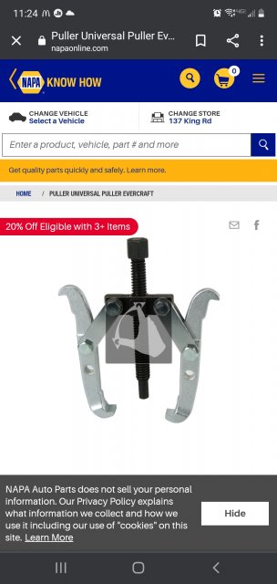

If you are talking about the two bolts that connect the flanges at the DP and exhaust I have. If so, I just used angle grinder to trim bolts off and a 2 jaw puller to push the bolt out the back side. Went and got new bolts washers and nuts. If it's the side on the downpipe and turbo someone else may have to chime in. The pic is the puller I used. Screenshot_20210410-232435_Chrome.jpg
