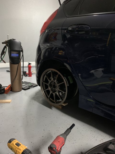

Everything reinstalled. I worried the bolt was going to pull the threads when I was tightening it but it seems to be holding fine. If it pulls through Iā€™ll probably end up drilling the spot welds and welding another nut onto the plate. But luckily no drilling or welding had to happen today. Was fully expecting it to come to that.
On a positive note with everything installed I was able to test fit my dekagrams for the first time. Tires get here in 2-ish weeks

This is one freakishly clean and well lit garage, sir.
I will second that. Fact is that it's so clean I wonder if his Man Card shouldn't be revoked. What ever happened to the romance of lying on your back starting up at an oil pan and getting the back of your head soaked with an accumulation of grease and oil dropping off of generations of cars.
