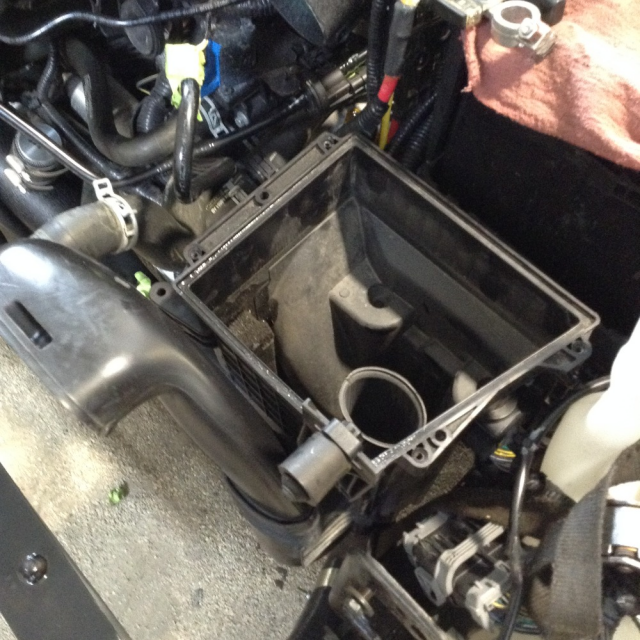

I think I will cut the bottom of the box off and put a plate of ABS plastic with a hole for a 3" flexible hose and route it into a hole I will put in the sedan's air dam. This hot mess just looks really restrictive. 1651088459934.png
292
394
Lancaster, PA, USA
wait, is that stock airbox? the last picture doesn't look like it
you could put a velossa-tech big mouth on the front too for airflow. don't know how much it helps, but it certainly doesn't hurt

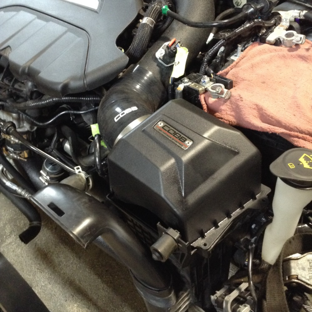

It is the stock airbox from the 11 sedan. The Cobb AF is built into a top box but uses the stock lower. My ST stock lower was crushed in the wreck. 1651093672956.png

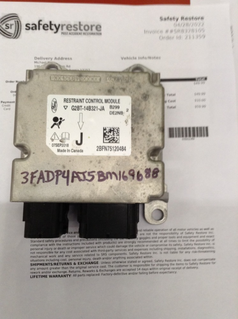

Another challenge: There is a death code in the Airbag module B1193 and Occupant module B00A0. A new one will cost me over $500 so I'm trying to get this one reset and cleared out. A few companies claim to do this at a fraction of new. They say if they can't do it then they will refund the cost. 1651231256943.png

Another challenge: There is a death code in the Airbag module B1193 and Occupant module B00A0. A new one will cost me over $500 so I'm trying to get this one reset and cleared out. A few companies claim to do this at a fraction of new. They say if they can't do it then they will refund the cost. View attachment 48486
Death code? Never heard that term, can you elaborate?

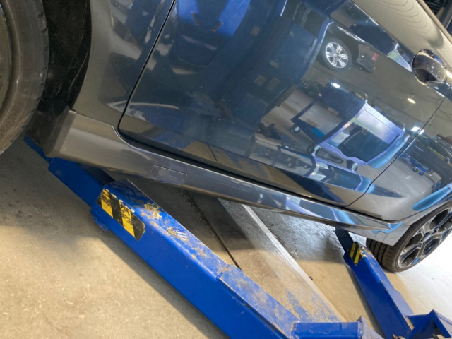

The side skirts from an ST will fit onto a sedan just fine. The holes are there underneath the rockers for the clips. There are no holes in the side of the rockers for the other clips so I just ran a piece of 3M tape along top inside edge of the skirts. There is a color variation as the ST and sedan are technically different colors. If it really bothers me, I will get them matched or just paint the whole car. 1651265570221.png
