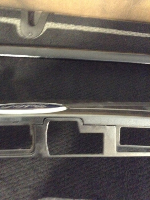

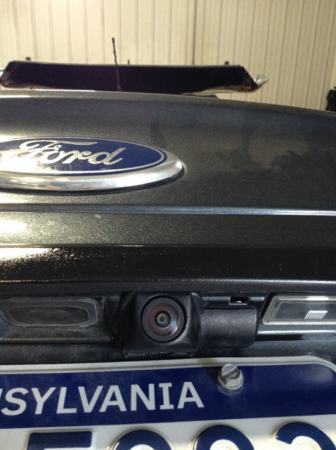

I installed the backup camera to the trunk lid of the sedan from the ST. I tried to offset it from center just the way it was in the ST. I had to cut an odd shaped hole. The first pic is the ST camera mount. I transferred this shape to a piece of paper and used that cutout to mark the sedan trim piece. Not sure I explained it right.

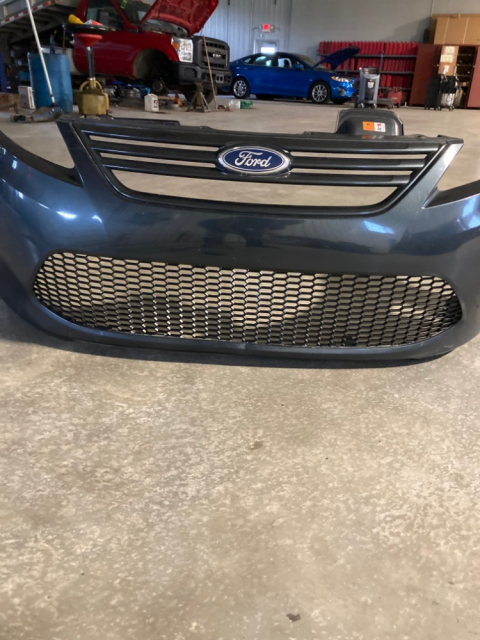

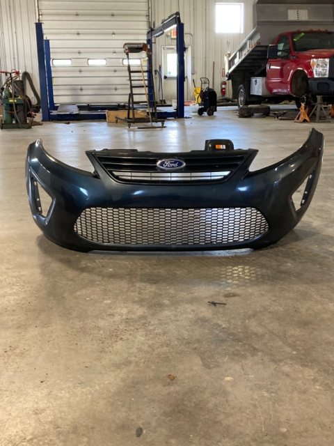

I have been busy with work but I found time to do this today. I took off the lower grille from my 2011 sedan and fabricated a honeycomb grille to open up the air to the rad and give it an ST look. I'm waiting on my condenser before I put the rad and crashbar back on. I've finished adapting the 3 wire brake/turn/park lamps wiring through a 3 to 2 wire trailer converter so it will power the sedan combination bulbs correctly. I had to use 10w resistors to simulate bulbs on the input side of the converter so it would flash at the proper rate. It's getting there. 1653166049966.png
