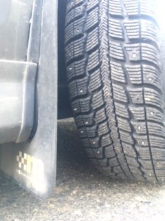

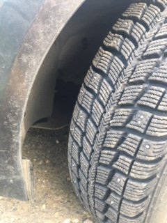

They are legal in my location but not in the summer time, and that's confirmed ^ They are awesome in the gravel and dirt and terrible on the road. Only one stud has left a tire since I put them on. Here is what they look like if anybody cares... It was the closest rally tire I could find without bugging team oneal for an actual rally set... I want reigers on my car but thats a whole other topic, really hard to get ahold of. I actually use it quite a bit in the gravel. No races are going on around here and all tracks are closed, same goes for dirtbike tracks. sad face.

Yeah I've had it on for about two years if you look at the first pic you can see it, barely, because my cars filthy
do you have the same one?
Yes, as well as a few others on here.
I only put it on for when I work on/volunteer for ARA rallies, so that I don't have to worry about the transaxle/oil pan/etc. driving down the stage roads, at about half rally pace speeds. [wink]
