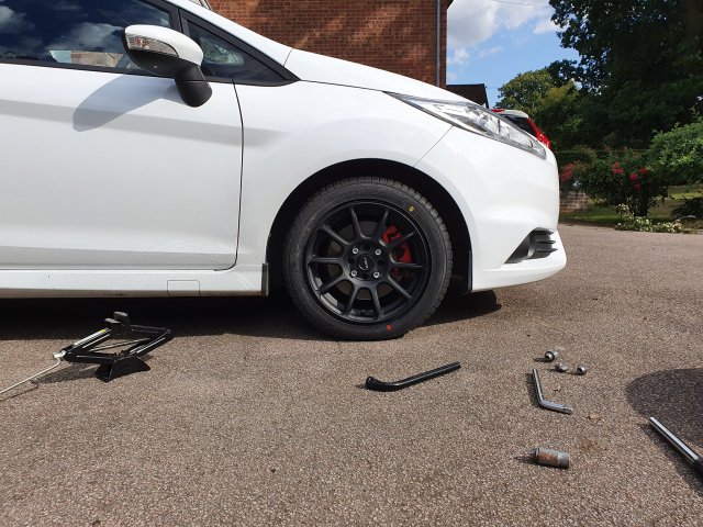

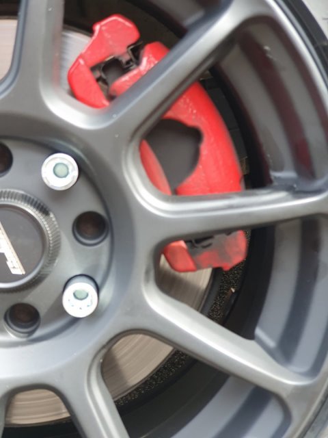

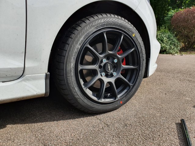

One set of Calibre Neo matt black, 15", Yokohama W Drive 902B tyres, 4 new TPMS valves inc fitting of that and delivery - £595 ( shade over 720USD) . Can't grumble at that. Means i can come back from holiday at the end of September and go straight to those and refurb the factory 17s and get them reshod with Michelin PS4 ready for the summer.
That is the 15" wheels and they fit nicely on my car. Happy with how it looks. Sits a bit high as it was just one wheel and i didn't bother to move it, trial fit only. Caliper clearance is absolutely fine.

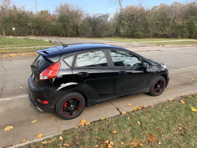

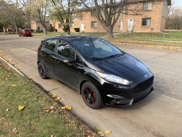

Just installed a set of winter tires on 15 inch wheels!
Wheels: 15X6.5 MOTEGI RACING MR116 BLK RED ST
Tires: 185/60R-15 BRIDGESTONE BLIZZAK WS80 SL
The TPMS sensors are showing a fault probably because of the different wheel size. I saw that there was a TPMS reset procedure in the owner's manual, will this remove the warning light in my dashboard?

Yes, you'll need to go through the TPMS training to get rid of the warning light. What lug nuts did you use? I bought the same wheels and found the OEM lug nuts don't fit.
16
4
Royal Oak, MI, USA
I bought them through TireRack and they came with lug nuts that fit. Not sure what kind they are specifically.
