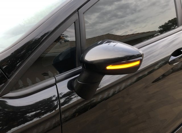

i was able to use needle nose pliers pretty easily.
unfortunately before I tried the needle nose, i didn't know there was a locking tab. the page that explains how to change the bulb in the owner's manual never mentions the locking tab so I know i messed something up in a previous attempts pulling/pushing the hell out of the mirror cap.
the mirror cap will not seat properly on my mirror anymore. it gets loose every in a couple days and i have to hit it back into place.

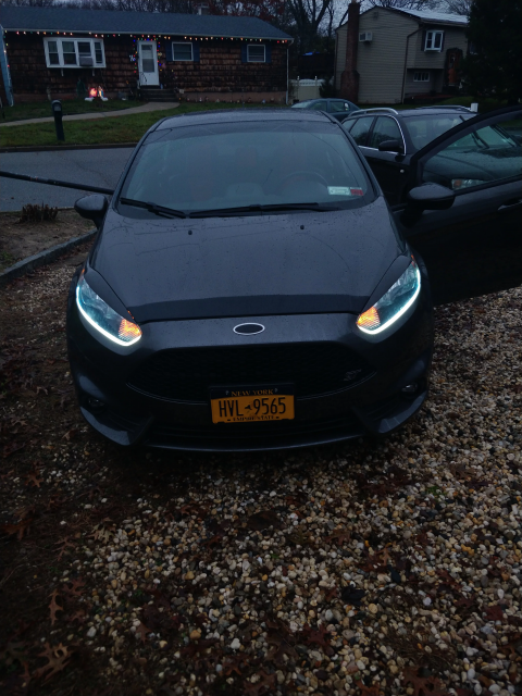

Hey guys, while I posted something about this in another thread, if you guys are interested in a bit more sequential LED lighting, I did this over the weekend.
Amazon Link Here
There is just enough a gap in the tolerances between the headlight and the bumper cover to install an switchback LED DRL/Sequential Indicator combo strip for a pretty seamless install. Best part is seeing both the indicators in the mirror and the new strip firing in sync. This is just a temporary addition solution until I pick up a set of the Depo black housing euro headlights.

Just made a short video of removing and reinstalling the locking tab without removing the mirror. Torch and a straight pic for reinstallation. I did not use the plastic pry bar that came with the indicators, just a flathead screw driver, a curved pick and a straight pic. No video of me using the torch to heat the pick and sticking it into the locking tab, was a little hard holding the camera.

/ View attachment 26200
What headlights are these?
Amazon Link Here
By any chance, did you happen to do a write up on how you wired up your DRL/indicators?
There's already a few write ups in doing do with the euro headlights DRL light. It's the same concept so I recommend referencing that. I currently just have them spliced into the parking lights so they come on when I turn on the lights. I plan on changing it in the future to add an add a circuit to the fuse box so they are always on when the car is on.

#95
Sent from my ONEPLUS A5000 using Tapatalk
Makes sense. I like the idea of having the white LEDs on as driving lights whenever the car is on. Should look good when you re-wire it.

Is everyone putting the locking tab back? Seems pretty secure with the 3 tabs .
Sent from my SM-A205U1 using Tapatalk
I haven't bothered. I agree. Feels pretty secure without the tab.
