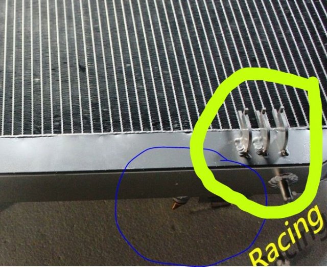

It’s the top. Photos provide proof, And it makes no sense to make an aftermarket replacement that doesn’t replicate OE.

Well if it's the top it's a bleeder valve and I'm wrong.

these hooks are specific to the top, they are used to attach the ac condenser to the radiator. they do not exist on the bottom.

You're right, the people doing the photos didn't even know up from down on that thing, the valve is on top, hehe...

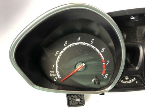

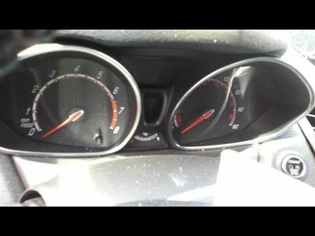

I know they changed the speedometer half-way through MY14 (different redline).
Can anyone clarify the change? Lowered redline or raised it? I'm curious.

Based on your images, the 2014 shows a red-line point of 6,750 while the later revision shows ~6,500.
Personally never paid much attention to red-line. Like most (stock) vehicles it runs out of steam well before getting there anyway.

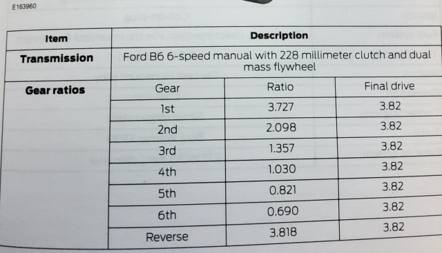

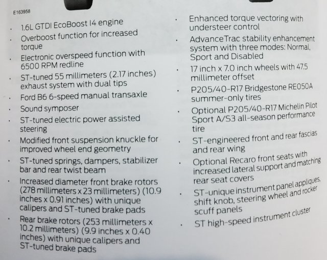

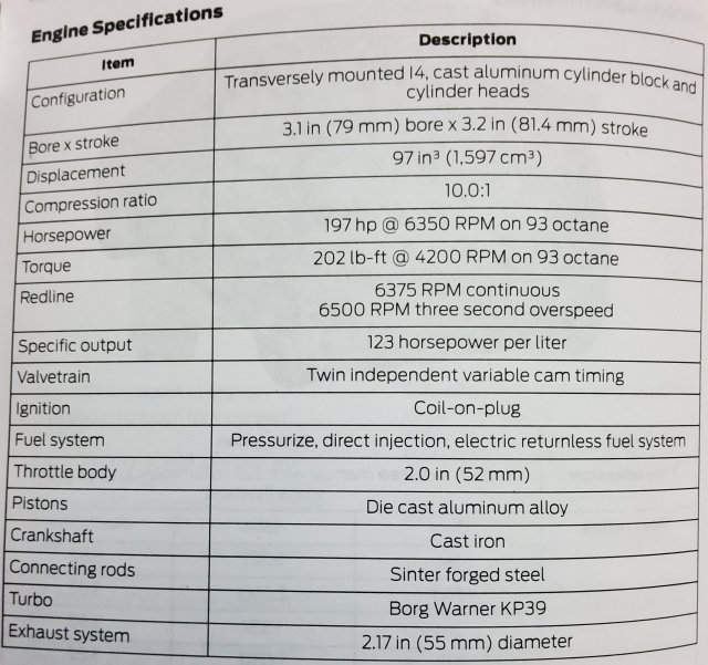

My printed 2019 manual matches the online manual: 8.5 qts rad. Here are some pics for the curious....it includes spring rate.
