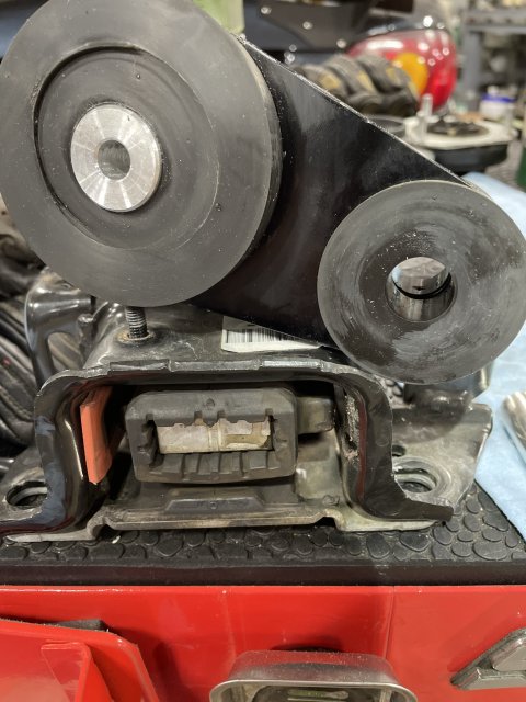

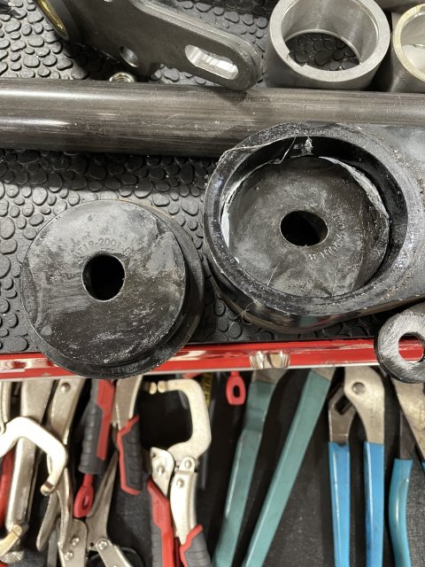

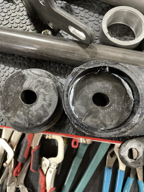

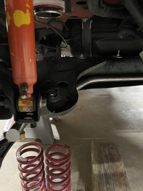

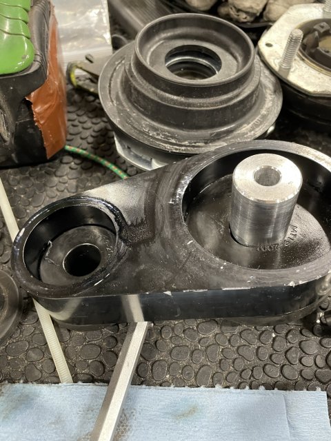

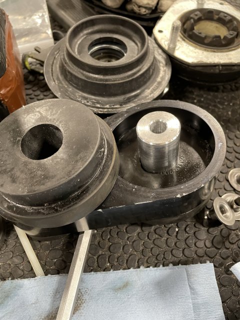

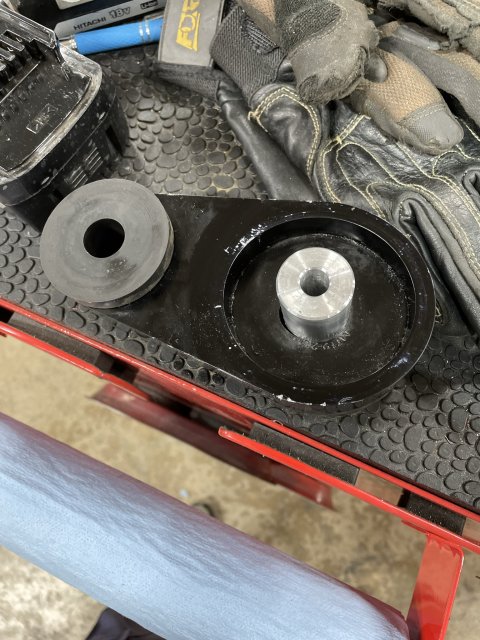

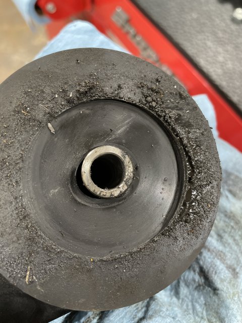

Started getting the car prepped for Barber. For a long time I have been fighting BRUTAL torque steer. I checked all the engine mounts and nothing is broken or shredded. A while back I modified the sleeve in the Mountune dog bone to make it larger and fix the ovaling that I was seeing with the original stainless sleeve.
67699739686__715C46DF-2515-4135-BEEB-70F1CFC6DDAE.JPG 67699922615__1E918DF4-DA9A-4FA5-87C7-26E0C5E9BA3C.JPG IMG_1535.JPG
Nothing looks bad though after my larger sleeve went in.

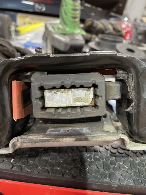

72118514472__4A9317AC-91F6-42C6-893C-CB5BE46873F8.JPEG IMG_3474.JPEG IMG_3475.JPEG

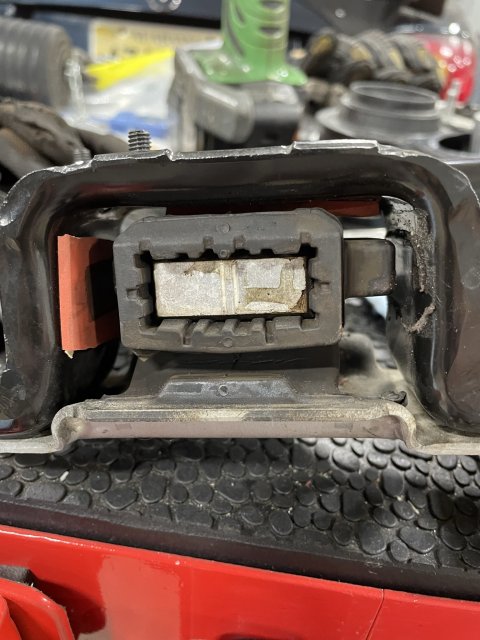

The trans mount looks OK, nothing scary. I added these Silicone Rubber strips back when I put my new clutch in. They don't really do anything as far as I can tell.
72118550670__85618EF9-A374-43C8-81BC-05C4A860F395.JPEG 72118489039__68EF375A-63BE-4DEE-89F2-C858C6D64ADF.JPEG
I ordered the two poly inserts from Powerflex from Ron last night, hope they show up in time. I am gonna do the Race insert on the trans side and the street insert on the Engine mount. I think I will make a larger sleeve for the big bushing on my Mountune dog bone and make a delrin bushing for the small end. I compared the durometer of the bushings on the Mountune part and they appear to be about 65a. I think if I don't like my mods I can machine some 75-80a durometer bushings for it later.

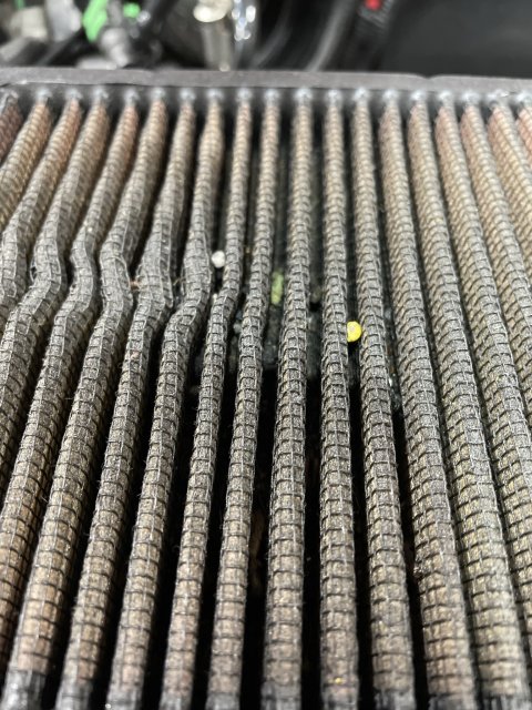

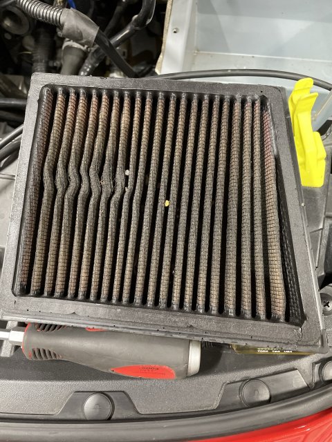

Time to clean the wildlife out of the air filter.

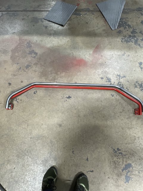

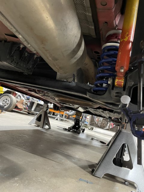

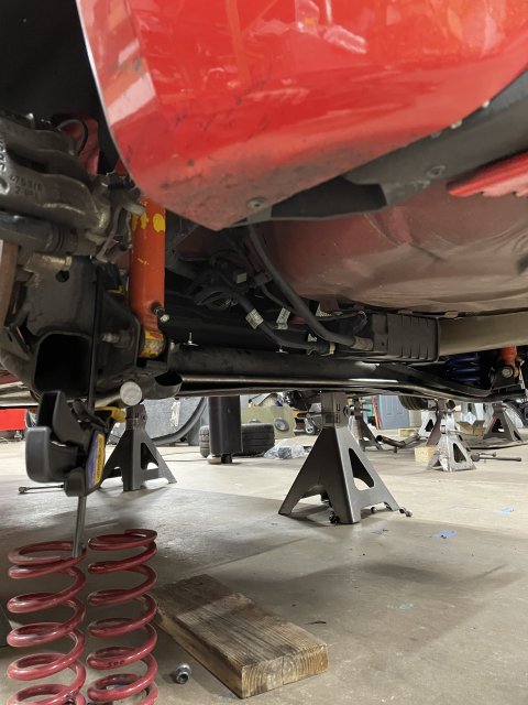

Also finally ready to bend the expensive material for the bigger rear bar. May get to that tomorrow.
I also pulled the back seat out tonight to start prepping for a rear battery mount in the spare tire well or passenger floor board. May also do a flat floor setup in the back to just have a "load floor". Probably gonna start measuring for a roll bar as well.

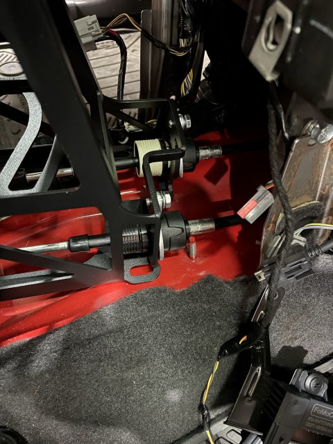

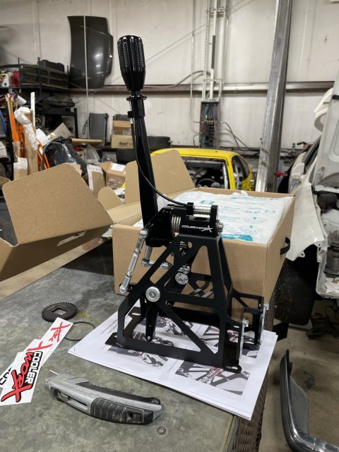

Oh Baby!!!
72279978276__E82B0F36-3CD6-483B-964C-11FDE8BE4638.JPEG 72279983975__E0514F88-555C-4E90-96BC-C2473A0B2ADD.JPEG

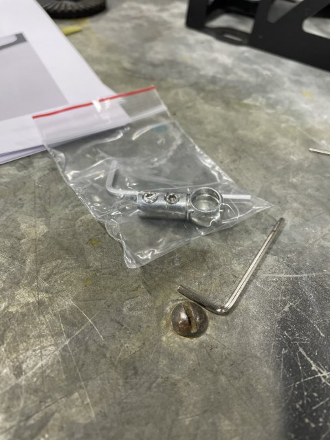

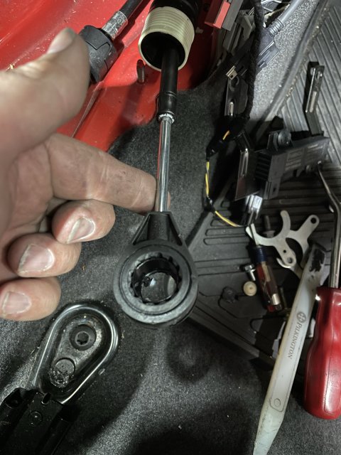

Looks like they realized a problem with the OEM forward and back cable and now send a replacement ball end fitting. You have to cut off the OEM plastic end, (which is squishy anyways), then attach this piece to the metal shaft on the OEM cable.
72281374193__F12A0E4B-A090-4345-82C5-73A80FC55E4B.JPEG 72280012302__6E269CA2-3AD8-4B46-BA0B-6290235F56B1.JPEG
I have some concerns about the length of the OEM cables. It seems like the OEM cables are too long when installing the Coolerwerx shifter.
Anyone else have this problem?

Oh Baby!!!
View attachment 59253 View attachment 59254
View attachment 59256 View attachment 59255
They are too long. Push hard as fuck
