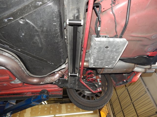

I think I've got the same rear Eibach sway bar you have, it bolts to a plate with two holes on either end and suspends in the air with no bushings shadowing the torsion beam right?
You running anything else? Asking because I bought my sway bar from a FiST guy that ALSO ran one of the torsion stiffeners like they sell on Woosh, looks like this and basically reduces the twist of the torsion member between the trailing arms, does that make sense? He sold me the sway bar because together they were too much and gave it a tendency to snap oversteer mid corner. Just a thought...

The VW guys use something like this bar, but they bolt between the two legs of the beam. I can't see how this really stiffens the beam. You are kinda relying on the stiffness of the bolt in bending and that seems insufficient to see measurable gains.

I have the Pierce beam brace and the rear Eibach bar. Have you checked out the Pierce beam brace. I had the TB Performance one before and like everything TB makes I can’t tell a difference in how my car performs with those products installed. Pierce stuff is obvious from the moment you install it.
Oh yea here you go, the Pierce bar Woods247 is using overcomes the bolt limitation Fusion Works mentioned by adding inner 90 degree bracing! This pic shows it. Are those inner braces nutted to the torsion beam? This pic shows my Eibach sway bar perfectly too. Stiffen that torsion beam from twisting and it'll have a dramatic effect on anti-sway.

So it doesn't actually bolt laterally? Those are just delrin braces? It kinda wedges up into the beam?
Yes so Pierce says because of those white machined delrin caps, cross bolting those lateral supports is unnecessary and could also compromise the beam strength. They also said it's not flat up top, so where it bolts in, there's a radius that matches the torsion beam. Quite a bit of engineering into their parts, super strong and light 4130 chromoly steel, AND they're CHEAP! Dam you guys I just added some Pierce bars to my shopping cart....
It wedges in. Definitely works. I can rotate whenever I want as long as I don’t get on throttle too early. The rear of my car is usually sliding unless I’m over 80mph then the wing takes effect and calms it down.

The Pierce/TB braces just work by bolting to the torsion beam and twisting the added tube as the torsion beam also twists. The TB relies solely on the bolts, which seems like a poor design. The Pierce Delrin snubbers add a second leverage point to keep the tube ends centered in the torsion beam - slightly better design, but still relying on the bolts in shear.
