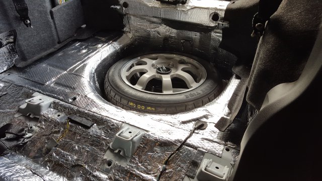

Is there any reason you don't want to simply do some sound deadening? I sound deadened mine quite extensively. There is still a bit of drone but nothing compared to what it was previously. MAPerformace 2.5"
Ideally you would want to do some simple deadening under the headliner as well. That would cut the drone quite a bit more.
Only small drawback is that you're adding a little bit of weight. some sound deadeners are thicker and heavier than others. But it might be maybe 15lbs total?

Only about 4-5lbs worth max for the entire car if you use the closed cell foam type which is great for absorption.
Butyl on the other hand is quite heavy
I actually do have some sound deadening. PO took the door panels off and installed it there, as well as in the hatch, like in your picture. The drone at 80mph (2.5K-4K rpm) is still pretty gnarly at times. That said, I haven't really examined how far the deadening goes, so maybe I just need to add some in the right places.
I actually have a second layer of closed cell in the hatch area. That made quite a difference. With the seats in it is quite quiet. I drive around with typically just drivers seat only and it is not as bad as undeadened stock with seats in.
