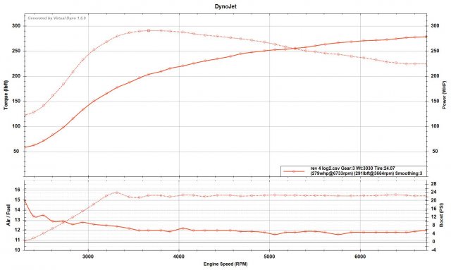

Wow, this is very impressive. Especially since ambient temps looked to be 90F. I threw something in vdyno just to visually see it. View attachment 24570
The car feels really great, i attribute the smoothness to my tuner, i love it. I'm seriously looking at aux come black friday, hoping strat or whoosh does a deal on their kits.
