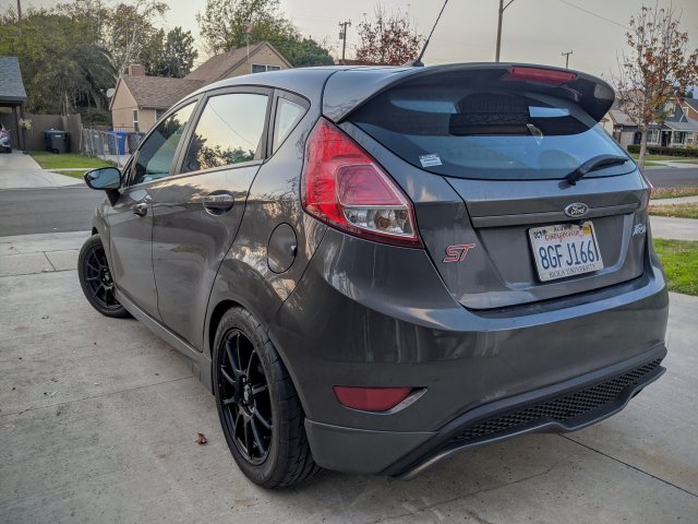

Did my third maintenance package service at the dealer, but the big news are the new shoes and socks! 16x7 Sparco Assetto Gara with 205/50/16 Indy 500
Is your car lowered?

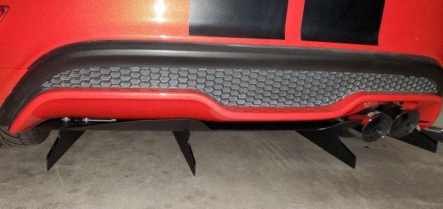

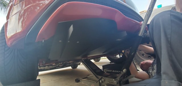

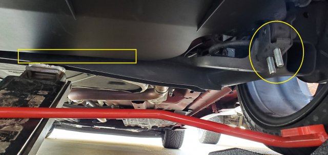

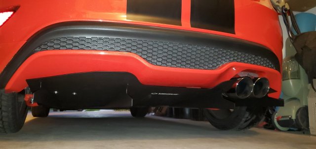

With the help of my two cousins, installed a rear diffuser. Not the aroma kind that makes a room smell good.
It was a PITA. Had to remove the rear sway bar and bottom bolt of the rear shocks in order to get at the front nut for the sway bar on each side. Sway bar takes up almost all the room to get your fingers in between the diffuser bracket and the frame cross bar to put the three front diffuser bolts on.

Looks good, but isn't that rear edge supposed to be tucked under the bumper?

D'oh! Having a bad start to 2020! Just noticed it's not tucked on the Verus website -- didn't notice that before.
So, I’m genuinely curious: what exactly does it do? I have these $90 fins from Velossa, but they are obviously for the looks, and I do like the way they look.
This is a much more substantial piece from Verus (and pricier, too) - so, there are expectations of some aero benefits.
Are there any numbers that would quantify the alleged downforce? Here’s a quote from one of the sites about aftermarket diffusers:
“Are aftermarket diffusers functional?
Rarely. Most aftermarket air diffusers are for show only. These rear diffusers do not efficiently increase airflow out the back of the vehicle from under the vehicle. They simply just add dead weight to the car and in some cases even increase turbulent air under the car thus reducing efficiency by increasing drag. Unless properly developed in a wind tunnel and the manufacturer posts graphs and numerical data showing efficiency increases through testing, the diffuser is just for show.”
So... ?
