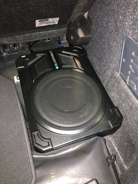

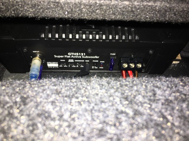

yeah me too. in my late teens and early twenties (so 20 years ago)I used to install car stereos but that was when you swap the head unit and run RCA wires from that. now with fancy screen stereos I know nothing. did you tap into the speaker wires with an rca converter? not sure what you mean by capped the main speakers, and where does the accessory wire go?

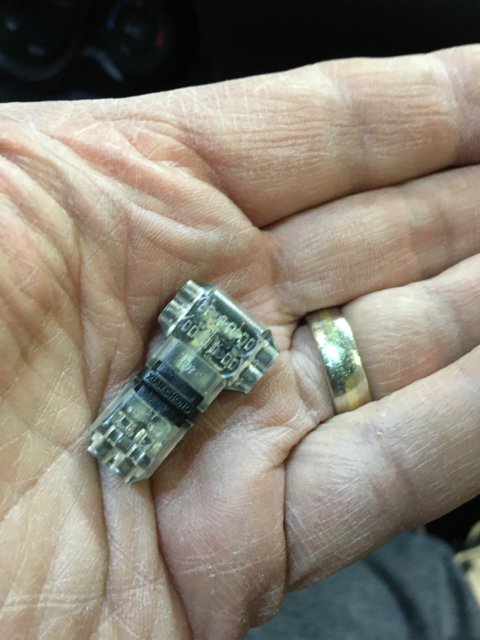

Used a PAC audio line level adapter and tapped into the rear speakers using really nice t-taps (photo attached) at the wiring connector at the head unit. ‘Cap’ is soldering capacitors on the positive speaker terminals to keep the main speakers from reproducing tones below 120hz. I ran the turn on lead to the moonroof fuse using an add-a-fuse. Oh, and I am 59 and still don’t know any better!

haha thanks for that
