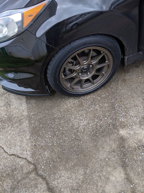

Yesterday I got some new meats. 205/50/16 Nitto Neo gens on 16x8 Dekagrams. I'm lowered on BC coilovers. Immediately after getting home I had to raise the car. It was rubbing like crazy. Also put on my Mishimoto downpipe today. So I guess I'm technically FBO now. This is the only picture I could grab before I raised her. Sorry I couldn't get a better one, but it has been raining non stop for 2 days.
I have the same exact/wheel tire setup (even bronze) currently on my factory suspension/ride height car.[thumb]
It does not rub on the actual fenders/wells/liners, but it does rub against my oversized, huge, SMS mud flaps on hard braking, and extreme steering angles. [:(]

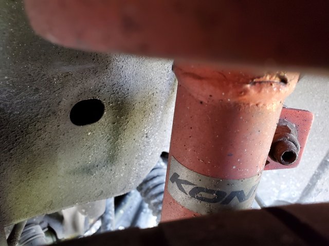

I installed one of the front mud flaps from Rokblokz and the top connector was giving me an issue. I could not insert the connector in the hole, so I enlarged it just a bit. But it would back out of the hole when I started to tighten the screw. Is this a correct install of the mud flap?

You should follow the instructions on this video. This differs for the instructions you get from Rokblokz. The top screw is tricky... you need to run the screw through the clip before putting it behind the fender liner. Then try to hold it with your finger behind the fender liner while screwing.
View: https://youtu.be/DJ2o9hhUKjk
I hope this helps. I love the flaps.

Thanks for the info and the photo. Mine is almost as tight as yours.
