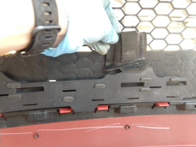

Finally got around to figuring out why my FiST #2 had the gap.
View attachment 33329 View attachment 33330 View attachment 33331 View attachment 33332
If you look through your grill and your tabs are missing, that be the problemo
One of those popped off the first time I took the bumper off but it lined up perfectly. The second time is when the gap was there.
I think I'll be putting in the V1 tomorrow so I'll take a look at it. Thanks for the pictures

No problem. I honestly don't see any other place where the misalignment can take place. I have checked all other points just to be sure. There are no other supporting areas aside from the top which doesn't do the job for vertical alignment.

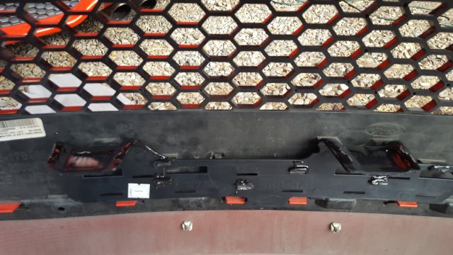

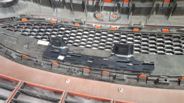

Got my V1 installed (it's nice) and still had one piece of those supports lying around.

Got my new ford piece in next day as usual
Then instead of running an aluminum piece I decided to use some epoxy to thicken up the bend area
What is the part number? Good idea on the epoxy

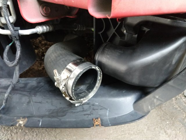

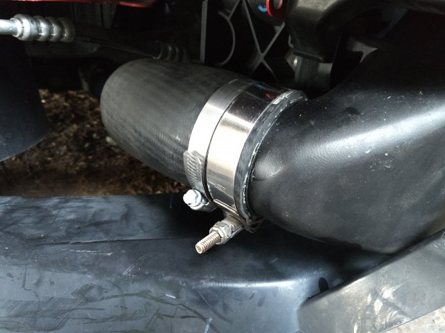

Had my hotside charge pipe blow off on the highway. I knew I should have reversed the way the clamps were on (a tbolt and worm) but sprayed a bunch of hairspray on the pipe and got things on there tightly. Fingers crossed.
The car drove fine without the turbo and I was lucky it was so close to home. Surprised it didn't throw codes or anything.
I will probably use some of the 'Qwik Steel' (or JB Weld) putty stuff to build up both sides of the bend in that piece when I order a new one to have when I replace the factory IC with the CP-E. [thumb]
It has held my torn off from catching the passenger side mud flap on rocks, rear bumper fender well tabs perfectly. [:)]
