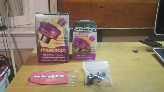

Another shoutout to ron@whoosh, ordered the power flex race inserts for both trans and passenger side along with the ARP bolt. Delivery was super quick even during covid. Air freshener was definitely a nice plus can't wait until install these on Saturday.

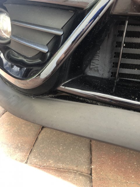

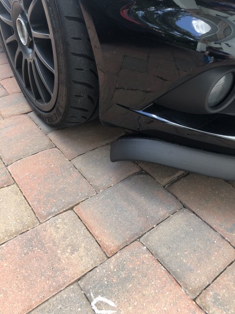

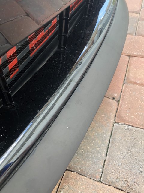

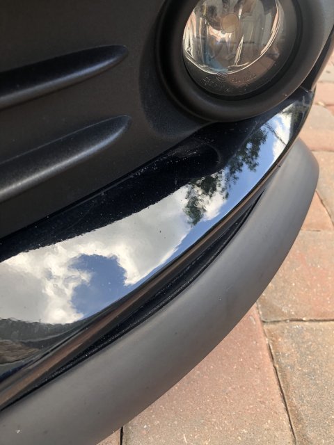

Here I have a bit of a 2 month update on my EZLip Pro. Some gaps have formed and the ends my the wheel have started to peel. That being said it has been through some serious storms and gone through massive puddles due to the infamous Florida summer. Also, dust and sand has collected in the gaps where adhesive was still showing.
B4AA960B-9095-4D64-A42F-76B1770E1559.jpeg D862B5FE-1BFF-41F7-BA88-D86C5D071C29.jpeg D46328ED-AA31-48FC-91BD-307ED5666D39.jpeg E5010DBB-5B09-4A01-8B74-4B11D45E0D16.jpeg
To fix this, I got some alcohol and a microfiber cloth and cleaned the gap areas on both the splitter and the bumper, and used some wider 3M automotive tape to help fix it, with some moderate success. In some spaces it is visible when you get upclose. Also some cue-tips with alcohol to help with the dirt in the tiny gaps.
5C97B572-0E02-44CA-839F-6F6FCED104B2.jpeg CDE80BA2-2DBA-453D-BB15-5D5956D761C8.jpeg 6A04057C-DBAB-4F4C-81B4-8E668EB2A5A8.jpeg C337BF4B-589C-4BD5-AF69-2CE255615BC9.jpeg
My verdict, holds well enough and is easy to "fix" the issue. Looks fine aesthetically from a distance, and serves it's main purpose of protecting your bumper from scrapes.

Nice update. I'm not sure how long I've had the lip on the car and I really haven't been driving all that much with the whole work-from-home-deal. I know that I've scraped mine once or twice on some unexpected dips in the road, but nothing major and I haven't had any extreme weather.
It's good to know that you can repair it like that if necessary.

Well got out of work early today and decided to install the powerflex inserts instead of waiting until Saturday. I know these mount inserts have been out for awhile but for anyone who hasn't done them or is thinking about doing them, definitely do it. Went with the race mounts and for me personally I only noticed a slight increase in NVH while at idle. But wow, these really clean up any slop leftover that the RMM or short shift kit and bushings left behind. Gear throws feel crisper and the power delivery feels more accurate if that makes any sense. For $85 bucks shipped it should be on the to do list for modding.
