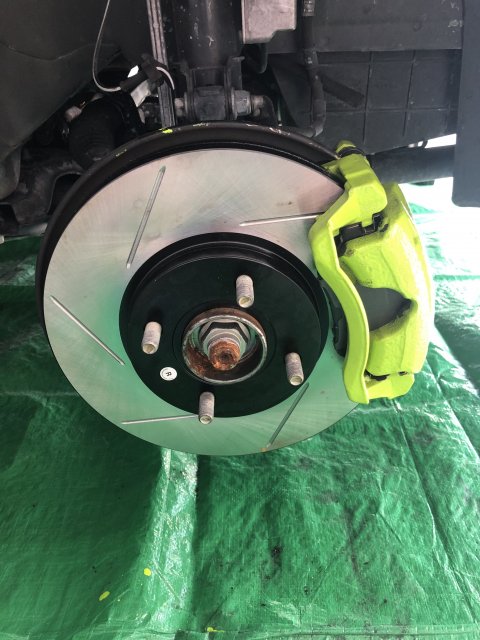

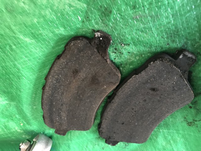

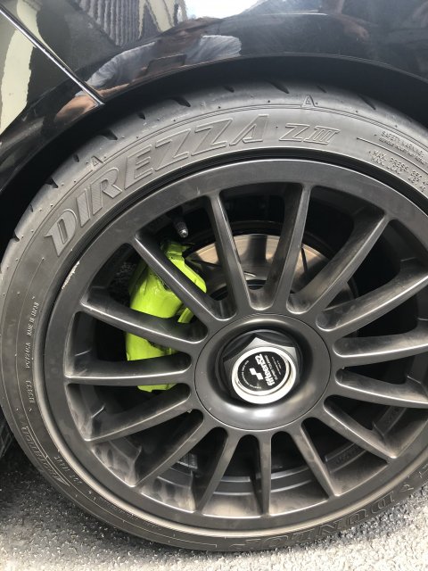

Painting is all done! Love the look. Swapped the toasted front pads and rotors too.
Hell yeah, that looks awesome. I've been toying with the idea of doing that color for the calipers, stock or bbk, as well. Good job!
Thanks! After a total of 3 days, a broken spline key, and probably 8 hours of work I'm super pleased with the look! Matches my lime ST badge inlays. Considering getting the side decals in the same color as well.

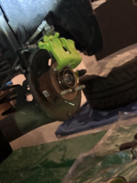

Painting is all done! Love the look. Swapped the toasted front pads and rotors too. View attachment 33692 View attachment 33695
Turned out very well. I take it you removed the whole caliper based on the photos. Any tips you can pass along for those us contemplating this paint work? Also, where did you get those rotors?
Hypergram
#11246
1,329
902
Yup, took everything off as far as possible before removing the brake line, no point in doing that. When taking the brakes apart, there's the 13mm bolt, AND another nut you need to hold in place with the proper sized wrench to properly take it apart, or it'll just spin. To put it back together, you'll need a large set of pliers to push the piston back into place aswell as a specific tool, pic below.
Do not skip the cleaning! Use a wire brush, steel wool or whatever abrasive thing you can use to agitate the dust on the pieces you're painting, and then use brake cleaner (regular wheel cleaner is also quite effective). Try to to paint or sand the rubber bushings.
If you're spraying, make sure to mask everything off as well as possible.
Bought the rotors right from Whoosh, Stoptechs. Got the pads from Mountune, street performance I think they were.
