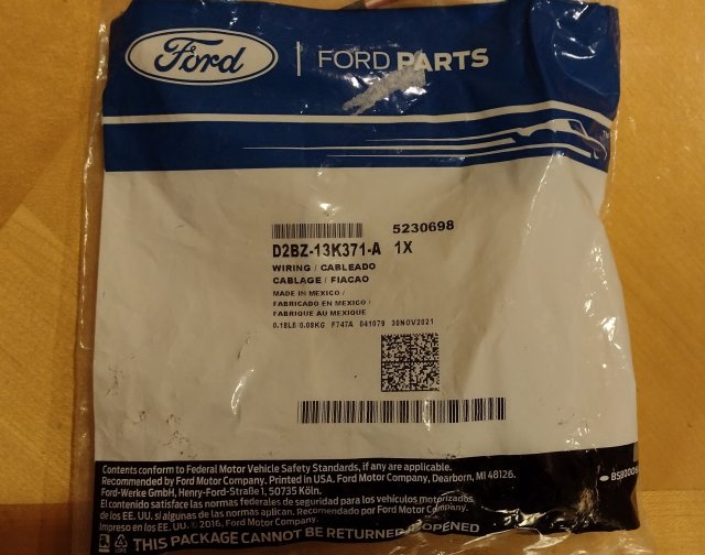

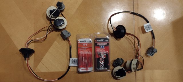

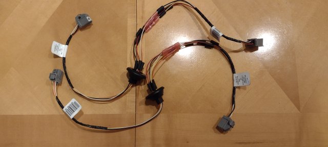

Finally finished up installing Euro Taillights! I'm sure there is a DiY somewhere here but it's plug and play once you cut up two USD harnesses to make one with a plug on both ends.
I do believe you can just re-pin the connectors also....but you got it done is all that counts and they function! Noice! I wish my FiST was as clean as yours! Mine is Dirty/SALTY AF!

Yes! they work, woot! I'm sure there was an easier and cheaper way but I didn't want to cut anything off the euro lights or the original tail light harness with the US lights. This way it's 100% reversible in 5 min.

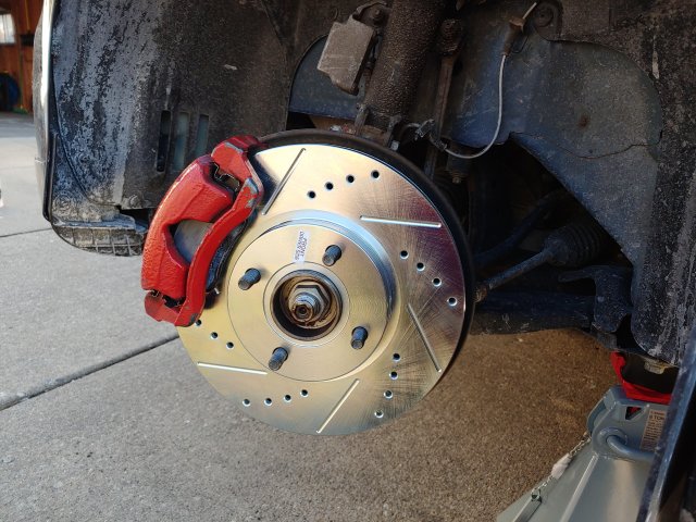

New pads and rotors for the front. The inside pad on the passenger side was down to metal. What a horrible sound it was making. The nice thing about the Powerstop kit is it has everything in one box, no need to buy any specialty lubes.

I shopped around and amazon had the best price. You'll need some Blue Loctite and a thin wrench for the slider bolts. I had to use bent pliers to hold mine in place.
Also, now would be a good opportunity to paint your brake hardware as you'll have complete access.
