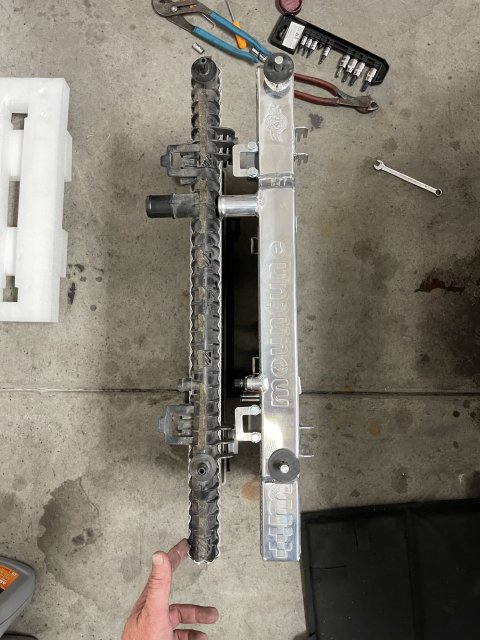

First up, is the Mountune Triple Pass Radiator, and WHAT A DIFFERENCE it has made! I was seeing 225* Coolant Temps in 100* ambient heat when cruising 80mph down the highway, which included 240* oil temps. Needless to say, after installing the Mountune Radiator, I haven't seen Coolant temps over 205* here in Arizona all Summer! [twothumb]
Difference in thickness between the stock and Mountune Radiator:

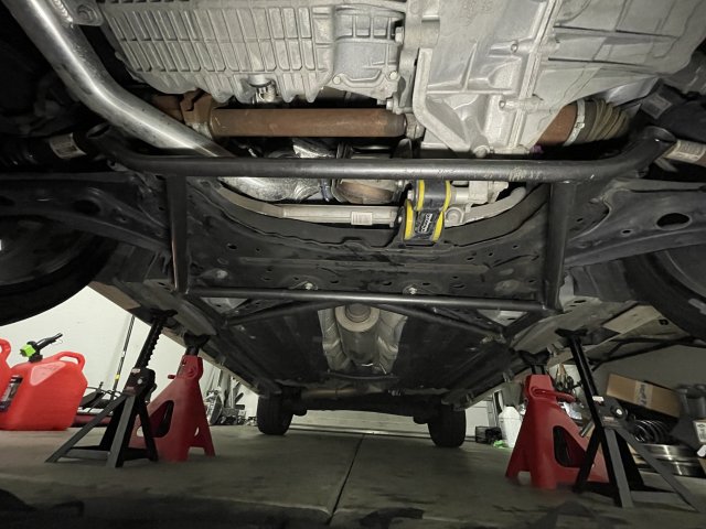

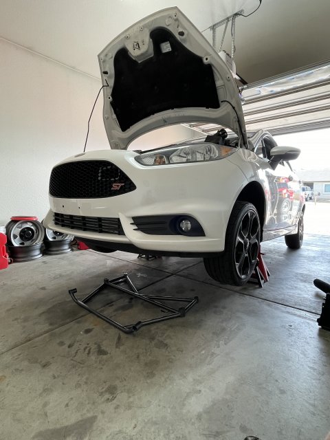

While I had the FiST in the garage, I also installed my used Pierce Motorsport 6-point Chassis Brace, and holy shit what a game changer this is for this car! [driving]
It took a couple of ratchet straps and some time to get all of the bolt holes to line up properly for install, but overall a pretty easy install! Make sure you loosely bolt the front lower bolts up first, then get everything else lined up loosely and tighten it all up!
I absolutely cannot believe how much better the car handles after installing the brace! Turn-in is sharper, the car corners flat, torque steer has been reduced by at least 75%, and I no longer spin the inside tire when exiting corners! This mod is 120% worth every penny to make this car perform like it should! [clap]
