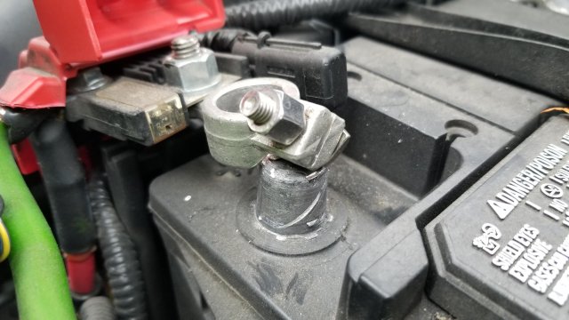

So I'm driving along and the dash lights start trippin' the screen throws up some messages and all the electrics just freak out. I've never seen this before in this car. I get to my office and find this. Apparently the body shop never re-connected my battery from when I got rear-ended. That was around 3 weeks ago and the cable has just been sitting on there this whole time. WTF! I guess I'm lucky nothing bad happened here. That had to spark multiple times.

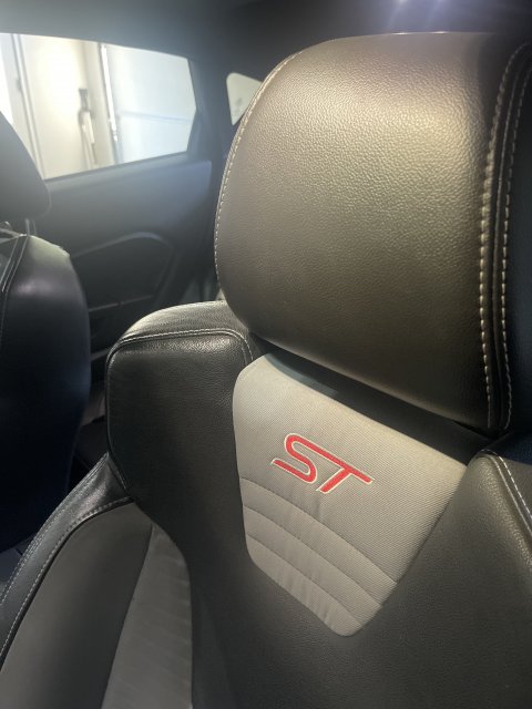

Is this an expensive upgrade?
Go to car-part.com and look for a 2012-2014 focus headrest. Looks like there are several for around $50. You can also find them in your local junkyard. This work with Recaros and regular seats.
(6) Focus headrest swap for Fiesta with Recaros (vid) | Fiesta ST Forum
I just did this upgrade myself.
You have to watch which head rests you are getting when you shop for these. I ended up buying a set off EBay for $95 shipped. There are sets that are not tilt adjustable and those tend to be around $50-$60. You want them to be tilt adjustable and will need to look at the pictures to see if there are slots on the underside of the head rest where the seat posts enter the head rest. Jeff's video posted actually goes over this around 2:05 mark.

Are they headrests from focus st recaros or any regular focus seat?
I have a 2013 Focus Titanium and the headrests from it will match perfect with the Fiesta ST Recaros down to even the stitching being a silverish color. Unless of course you had the Magma recaros.
