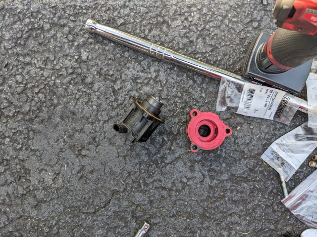

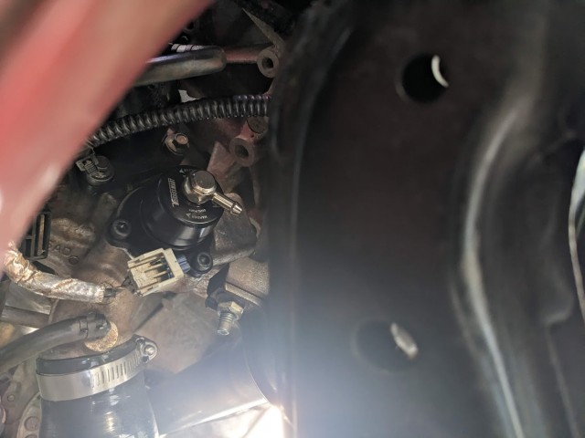

My Turbosmart blow off valve came in today. Wasn't too difficult to install on a jack stand. 1 bolt was difficult to get but the vacuum hose routing was the easiest part. got a defender plug in the kit as well so no codes to deal with. Sound is less annoying than the stock bypass valve with a spacer. So far I'm not seeing the same weird frequent venting I was experiencing with the stock setup. Those vacuum blow off valves are supposedly discontinued so this was a great find. That Boomba spacer is gonna have a special place in the garbage bin.

I realize this is a “no shit, Sherlock” comment but make sure that vacuum line is secured where it can’t contact any hot parts. Mechanical BOV FTW!

What would my veeport symposer be? I thought it was a vacuum. Line goes to the map sensor adapter
