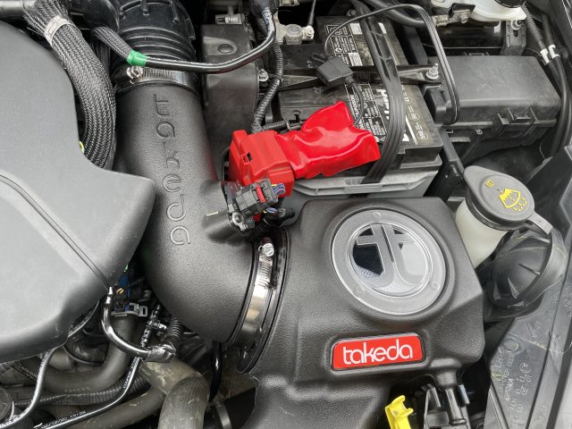

Been running Oem intake to crossover and oem cat and exhaust with the Hybrid for the past couple of years. Decided to change things up a bit with a retune. Started with the Whoosh intake and induction hose, and although really opened things up a bit, was a bit to noticeable for my preference. I prefer flying under the radar…
That's sold by aFe, correct?
