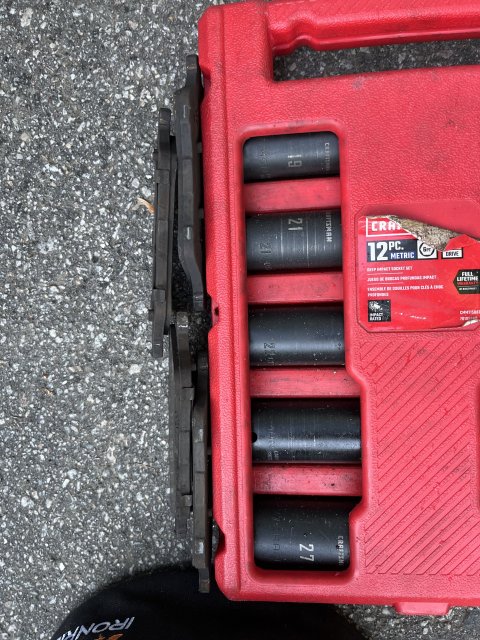

Also did my front brakes. I got 24k out of my EBC yellow stuff pads that I won in a giveaway on this forum. I went with the motorcraft pads and cheap rotors. I also managed to overflow my brake fluid reservoir while compressing the caliper pistons. However this is not my first time spilling brake fluid on everything so I knew exactly what to do (rinse with lots of water for anyone curious)

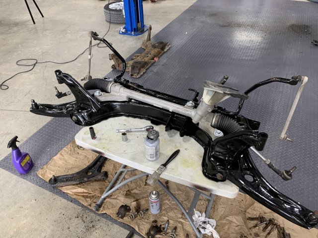

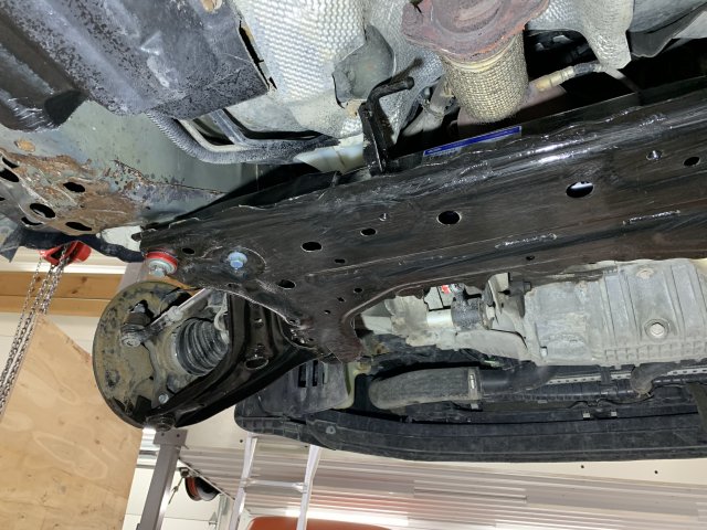

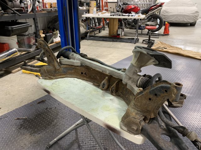

Replaced my subframe that was completely rotting out.
Cleaned, degreased and coated all parts with Fluid-Film. New bolts all around to compliment.
Whoosh subframe centering kit and again, Fluid Film spread around with a paintbrush on the underside.
The driving difference is quite drastic, sharper turn in, solid feel on bumps, much more stable around road ruts.
I'm good for at least another 10 years in the salt!
Trying to figure out how the subframe went before the exhaust?
Man that looked like an underwater shipwreck. Wonder what Sponge Bob does for rust-proofing on his rides...
My prior car rusted out ass-first. So I've been paying attention to the rear and so far what's behind the rear bumper ain't look'n nice.
