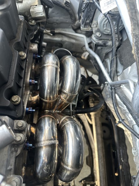

That really does look good. Does it have a performance benefit, or mostly just appearance?
No first hand experience, but reading around it seems to be like most other parts on our cars. Helps some but not much on a stock turbo, the larger the turbo the more it helps.

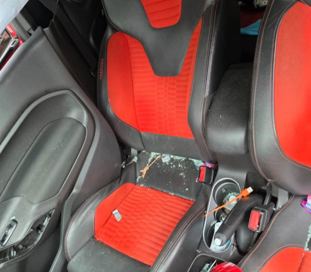

I'd be immediately suspect of the seat frame on that seat. I worked in crash testing for a decade or so, a side impact like that most likely distorted the floor pan which would bend the seat.
How much of a hit impact can the seat air bag sensors detect before they are set off?
In other words; can the side impact be of enough force to distort the floor pan and bend the seat rails without triggering the upper seat bolster air bags??

Good thought, looking at photo, the passenger seat looks like it got crushed. The guy said $800 for all. When I asked if it frame was bent. No answer yet. Maybe I'll just ask to buy the driver seat and offer $ two fiddy.

Yes, especially on a passenger side hit. The seat has an occupant sensor that will disable the bags on that side if the seat is empty.

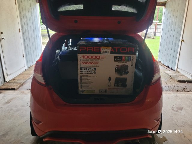

Put it in truck mode (back seats down) Harbor Freight's largest generator will fit in the back. You have about 1 inch to spare through the hatch opening if its centered up. There's also a bin of ham radio stuff, an old surplus military radio and a set of ramps in there.

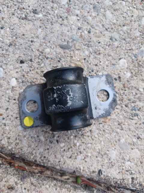

I had some extra money after a stock sale and thought it would be a good idea to replace the sway bar bushings. I figured they were due with 70k on them especially how aggressive I am in the turns. They were a PITA to remove, and they didn't look bad at all. They also seemed just as stiff as the purple bushings from Power Flex. The stock bushings are mounted to a flat piece of steel which I didn't know about, hopefully that won't be an issue. So I have to say this mod might be one to skip.
