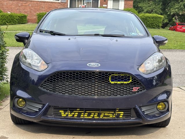

Ok so I pulled the dumb bumper off to replace the IC clamps with the Summit T-bolt ones. Used some of my son’s Mohawk gel as insurance. While I had it off, I installed the yellow lamin-x covers on my fog lights and removed the gray grille from the intercooler area so you can see the IC logo better.

Glad to hear it all came together for you. The car looks awesome!
Thanks. I appreciate your help. I got it up on ramps and probably could have just reattached the popped hose but it looked unlikely that I’d be able to swap both clamps and properly reinstall them. The bumper isn’t too bad the second time either. I got it all done in probably under 3 hours tbh. I’m pretty sure the first time it took 3 hours just to get it off.
