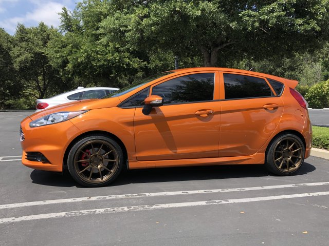

Not many pics of gold Titans on the forum. Here's my contribution. I did have the same issue as others with the rear caps not fitting; these are the 17x7.5s. I am going without until I figure that out. Regardless, I LOVE the look paired with Eibach springs.

Looks awesome! Since they're the 7.5, I assume they're also the 40mm offset?

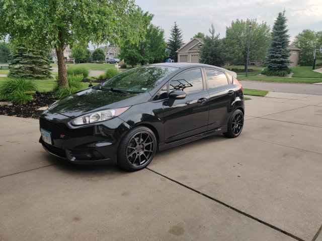

Finally got around to installing these today.
17x8 Rota Titan, +45 offset, 63.35 hub bore (FiST size). Suspension is Bilstein PSS with very moderate drop.
Fitment is great...flush with fenders and I've got about 5mm clearance in the front from the strut body.
Tires are 205/40/17 Blizzak WS80. Yes they are stretched pretty bad but it'll work. Probably the silliest winter setup ever, but I love the way it looks! In spring i'll swap out the Blizzaks for something in 215/40/17.
That's awesome you got these in the factory bore size. I didn't see that option anywhere.
They're pretty good wheels. I think the factory bore size is a rare run of wheels specific for the FiST
I have to be 100% honest though. I have NOT been happy with the finish of the royal sports bronze. They are flaking already. I'll probably have them stripped and powdercoated at some point.
I just ordered a set of bronze for my orange spice. And have Swift springs on order from Ron. Cant wait
You will love them. Congrats.
My original order says they were 45mm offset. I also ordered from 18Racing but through their Amazon storefront. I seem to recall seeing the 2 different offsets when I was shopping around.
The gold has held up perfectly, though I also don't use them in the winter; I swap back to my ebony stockers. Enjoy!
