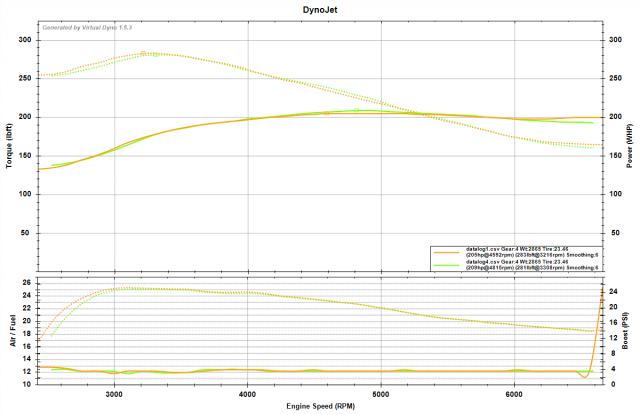

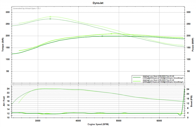

This is likely the last revision, so long as Jason even deems it safe. He added a bit more timing. He did warn me that if I saw more ignition corrections than normal to add another gallon of ethanol. I'm not sure what was "normal" so I took 3 logs of my normal mix, then grabbed more E and took another 3 logs. I gained HP but lost just a bit of torque. Everything on my car is stock, except for step colder spark plugs. That being said, I'm making about +20whp/+33wtq over my 93 tune.
This graph is latest (E40?) vs my last E30 tune.
And this is latest tune E30 in orange, E40 in Green, same tune, taken within 30 minutes of eachother. The 3rd gear logs were similar, either torque was the same or lower on E40, but HP was up, we're talking about the difference of +/-5hp 5tq. My OAR's on E30 were running at -0.99

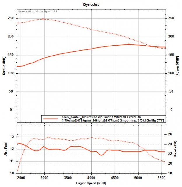

Mountune 91oct Stage 1 initial. Car's stock except for Mountune airbox with high flow filter. I always run 93oct top tier. Run was slightly uphill, so reading a little under probably. No wind. Light rain. 30.05in/Hg. 37F. I'm sure the drag effects of a wet road and light rain also skewed things, here it is anyway. I didn't pull to redline, it was cold, wet, and dark... nothing special. Wish I'd found out sooner Vdyno was free. I had JUST swapped out the paper filter for high flow and the comparison would've been nice.

Several members here including myself have not seen any improvement in spool, hp or tq with high flow filters. I run the paper filter as a result.

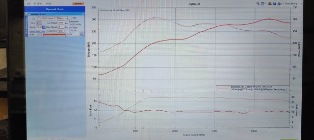

Does anyone have a graph of a JST E30 tune mixing with 91 octane? Curious to see how it compares to mine and curious about your mods.

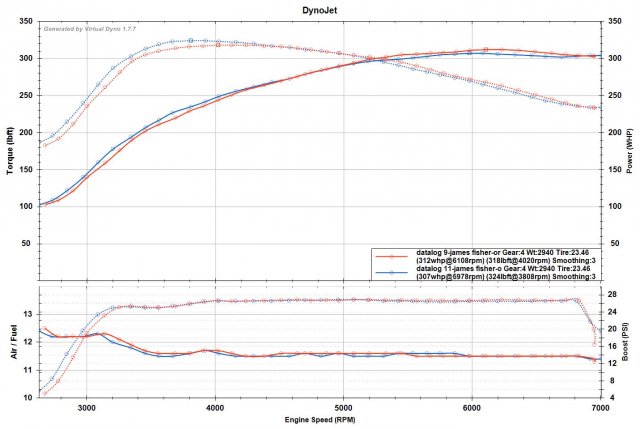

dizzy e40a, turbosmart 7psi wastegate, 3” thermal exhaust, whoosh crossover/induction hose/short ram intake/turbo inlet/charge pipe, GFB DV+, CPE intercooler
not super happy with the results, wonder if I need to clean the intake valves…

Interesting that you’re running the 7 PSI WGA. I asked Jason which WGA he recommended when I was installing an S280 on mine, and he pointed me towards the 14 pound unit. What boost levels are you maxing out at? Does the thermal exhaust include a downpipe?

The 14psi is the move for the s280, this is on the stock turbo. I think you can go with the 7/11/14/ what ever psi tune+ has and get about the same results with the stocker. Jason’s e40a tune uses the 7 psi wga.
I hit between 25-27psi, stock downpipe.

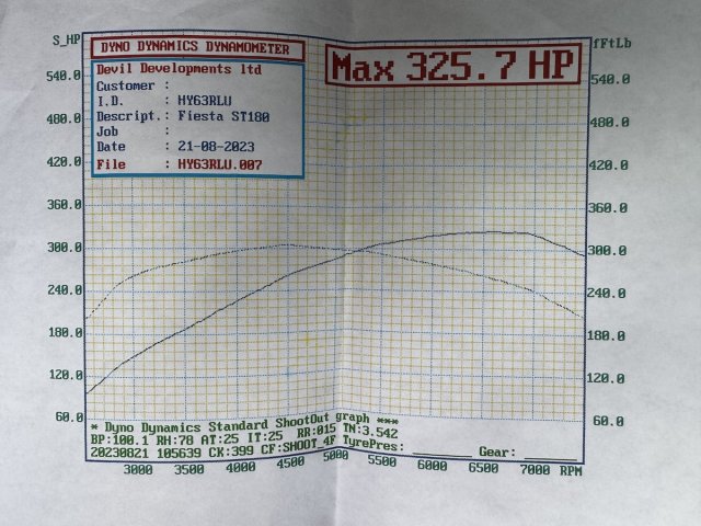

Pumaspeed X47 hybrid turbo, Milltek 2.75" turbo back exhaust, all turbo pipework uprated, Mountune airbox, MAXD stage 3 map by Pumaspeed. 99 RON fuel.
