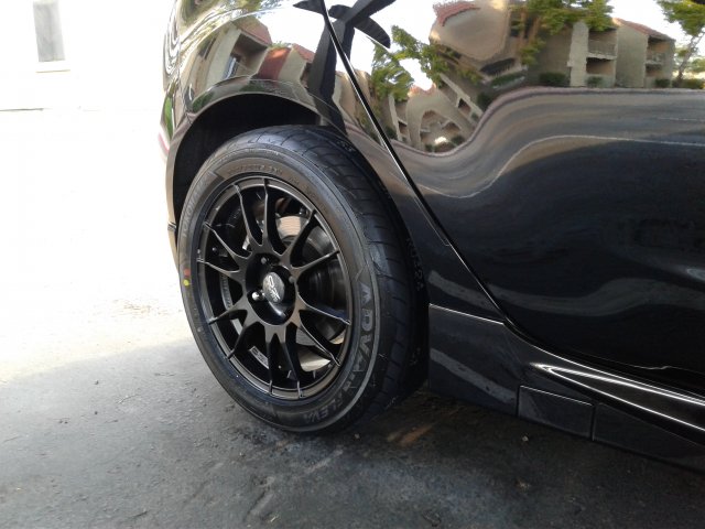

Fitted my new 15x7 +42et OZ Ultraleggeras wrapped in Yokohama Advan Fleva V701 205/50:D. Very noticeable weight difference when lifting/mounting:cool:(y)

Thanks! Took the car for a spin and the ride is for sure improved. All the ripples, cracks and manhole covers are soaked up to the point I don't need to consider dodging them anymore. Turning is maybe slightly affected by the taller sidewalls, but the grip is the same. Without a doubt, I'll be lowering her later this fall.

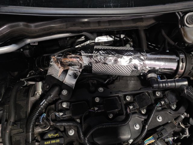

OK, so not today, but projects over the last couple of weeks finally done. I was given some heat blanket material so I bought some heat tape and wrapped the upgraded aluminum crossover, using blanket right in the middle where it's right above the turbo. Helped with charge and even coolant temps just doing this first...

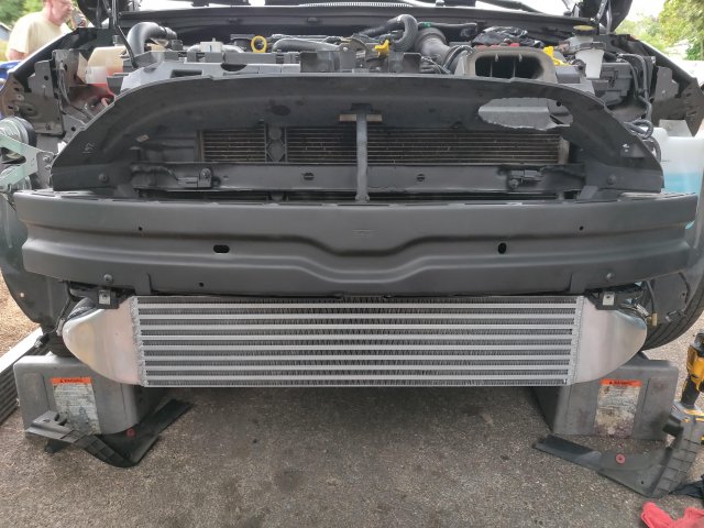

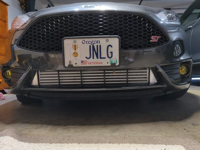

So then I installed a Pwnall Performance intercooler. I painted the support/crash bars black with a bit of rattle can flat my buddy had left and shaved the grill with a RotoZip tool. It's far from perfect, I need to hit the grill with some gloss black to get the areas I screwed up. But wow, what a difference in charge temps and cooling overall, I need a wash now after enjoy the intercooler for a couple of days on my e50 tune!

I wrapped my cross over pipe in gold reflective tape and noticed a difference for sure, paired with the Ron's V3 Intercooler even in this heat, cruising I stay about 5-8 degrees above ambient. Out performs the stock core in every way

Yep, my intercooler is exactly the same as Whoosh V1 and Depo and I have no regrets... even for the low end it's a very decent piece that works well. Yeah, can heat soak a bit in stop and go but barely goes up at all on pulls, just love it... and a lot of people don't know, but a crossover alone is good for 10 torque, but gotta wrap it with heat tape at the least.

Been thinking about doing this with the crossover pipe for a while. Maybe just the bottom half of it least
