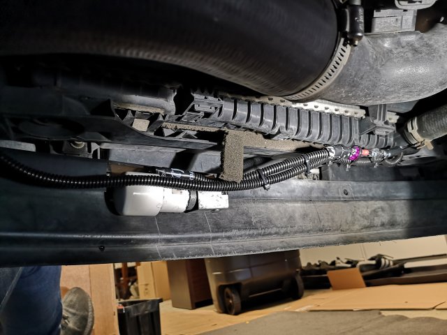

That is something out of a James Bond movie. Do they make them for the back as well?
Ya they do but it would be sliding vertically, up/down, and you'd probably have to cut the bumper. I only did this because in BC Canada it's illegal to not have front plates, so now when I see cops, I'll just slide my license plate back out lol. You have to trim the lower lip that's behind the bumper, right underneath the radiator, and make a spacer bracket so that the slider mechanism mounts parallel to the ground to make it fit. I put pvc pipe with a cap over the motor and sealed it with silicone rtv. I can make a how to install one of these thread, if anyone's interested. Edit: I used pipe wrap because that's what I had at the time, but maybe it'll hold up better than electrical tape. Black electrical tape would give it a more cleaner oem look though.
