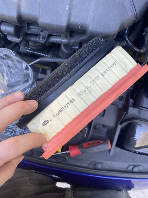

Rang Ford parts and they basically said the same.. guy at Porsche thinks it's my high flow panel air filter that's causing the 3 cylinder startups.. thinks it's the K&N filter oil that's causing it.. I don't believe that's the problem tho.
I think it's either an injector or a faulty sensor of some kind..
New plugs and coils has had no effect on the problem.

Just my 2 cents here but as a tech I have seen where oil will get on the MAF and cause all kinds of problems. I suggest you take it out and clean it with brake clean. Then put a dry filter in there and see how it goes. Engine load is calculated by MAF, BARO and BOOST pressure. If the MAF is skewed due to oil insulating the hot wire, the ECM thinks there is less air entering the engine. In Duramax diesels, it can cause the Allison trans to burn up because internal line pressure is determined by calculated engine load. If the MAF is poisoned and can't be cleaned, it will need to be replaced. Compare the grams per second on yours at the same idle RPM as another member here with the same mods. It should be close.

These vehicles don't have MAFS they are MAP based systems.

There is a Mass Airflow Sensor in the intake tube either in the air filter lid if it's stock or in the aftermarket intake tube just after the first elbow. Ford PN#
8V2Z-12B579-A
Am I missing something here? Are the Aussie cars different then the US ones?
11,889
8,335
8V2Z-12B579-A
It is used for Temperature reading not Air flow as I've read

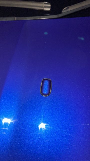

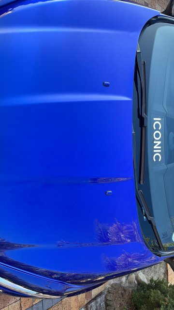

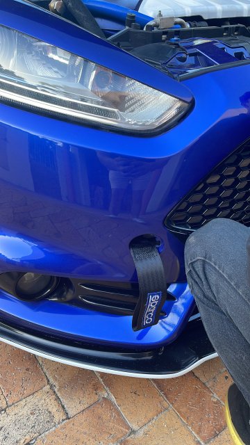

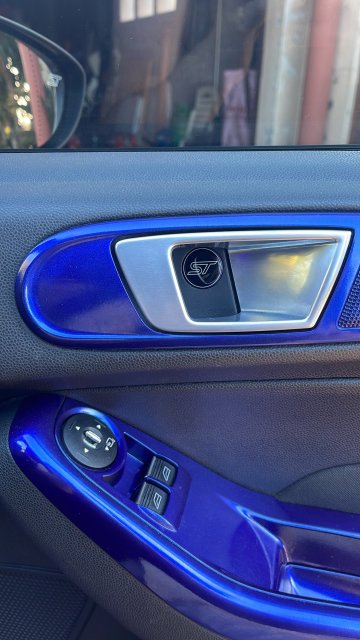

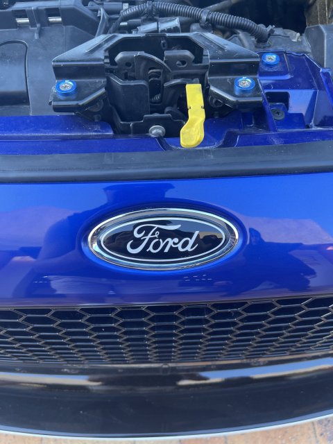

Here’s new pics of my car after the 15% tint, new 2.5in straight pipe exhaust, under glow, custom boot, front bumper and bonnet and side skirt resprayed. Also wrapped the window surrounds gloss black. Colour matched the sprayer nozzles and the wiper bolt covers. Got some new gel badges custom made by my sticker guy. Custom made a sparco tow strap mount too.

I wish.. I clean the MAF every time I clean the air filter, I use proper MAF cleaner. If it's not a MAF it's the one mounted just above the air filter.

That other sensor below the throttle body gets dirty too... Oil sits down there so I noticed when I did a throttle body clean.. they easy to take out without removing the tube? I might do another throttle body clean and give that sensor a spray with the throttle body cleaner..
