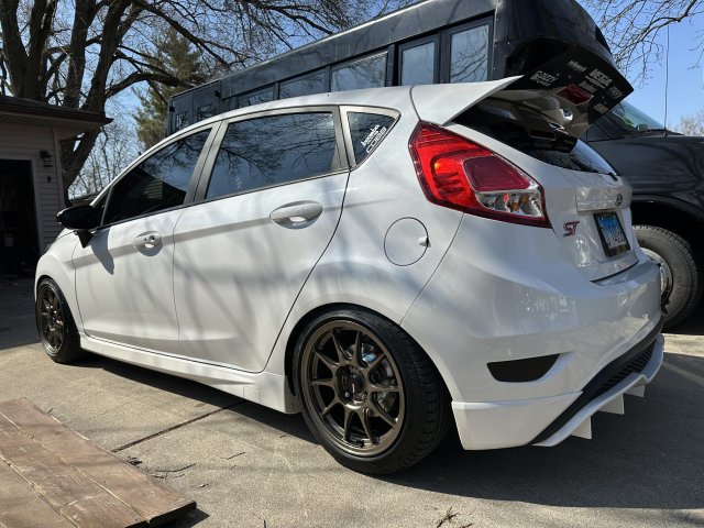

Past few days I installed new coilovers, rims and tires, boomba short shifter, boomba shifter base bushings, 2j racing cowl intake, esp downpipe and a new stage 2 tune from Dizzy.
Next up will be a new reverse lockout, New grimspeed knob and a new leather shift boot from redline goods.
Wow, those Acceleras have some major rim lip protectors on them! [thumb]
Again, let us know how they perform in the future, as they are the only higher performance all season rated tire in a 215/45-16 size, anywhere.

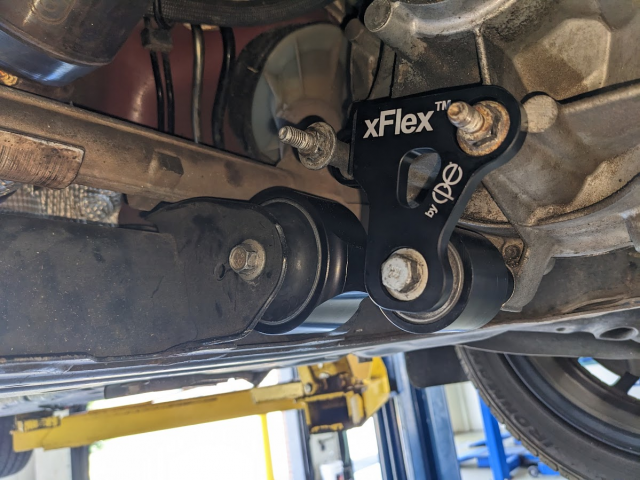

Finally had a chance to work on my car again. put my passenger side and transmission mounts on. I was getting some really bad vibrating doing 50 in 6th gear if I gave any gas. That vibrating is mostly gone now. I'm also getting less torque steer. I still need to do my drivers side motor mount.
I have the cpe passenger and rear mounts, too. When I installed the passenger mount, the NVH increased significantly (compared to the PowerFlex pineapple that was in there previously). Is your experience the same? Curious whether adding the driver side mount makes it better or worse, so looking forward to your update.
Granted I have powerflex race inserts on each of them, but the drivers side added way more NVH than the passenger.
I've wondered just what is the actual, experienced NVH difference between the CP-E and the Vibra-Technics passenger side mounts, regardless of the durometer difference between the two. [dunno]
My stock mount was bad as was the boomba mount so I was getting an insane amount of vibrating before I installed the CPE mounts. I still get some vibrating but it has significantly decreased since I opted for the 55A over the 75A mounts.
