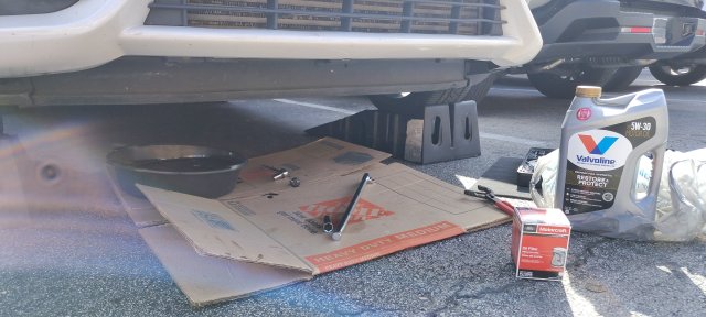

And so, another oil change has come and gone. Waited until the cold snap left Florida to pull this one off. Also went big filter. Turns out my buddy with a Crown Vic bought an extra FL400s and just gave it to me.
But while priming the engine I nearly killed the battery again, so time to use that tender I bought again, left it on the juice for 10 hours - charger said it was charged by the time I woke up at night to go to work.
I guess it's time to start budgeting a new battery. This one is from 2021 and it's obvious that it's on borrowed time.

^^^How many miles on it?
That Restore & Protect might be unnecessary for any engine with < 60K miles on it (unless it lived it's whole life up till then with cold starts and short tripping in cold weather, or all stop and go traffic jams), even though it would not 'hurt' anything.
Its got like 75k miles on it. Picked it up with 66/62K (Can't really remember, I'm probably mixing it up with the mileage I picked up my Civic LX that preceded this car). The odometer is in KM since I swapped to a Canada metric cluster and it jumped forward like 1,800 km since the new cluster was from an older car than mine with a slightly higher readout. Last I checked the odo it claims about 125,380-something kms on it.
This car also has a lot of deferred maintenance on it, so that's why I went with the Valvoline oil - in the "not a year" I've owned it I've flushed and swapped the coolant, done engine mounts, brake fluid, and a clutch master cylinder along with a lot of use of Liqui Moly Direct Injection cleaner. Better to be safe than sorry.
