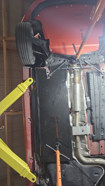

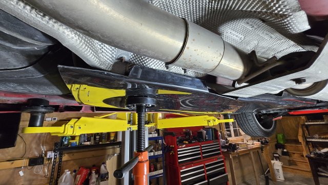

I fabricated the left side under body aero panel today. Created a cardboard template, then cut and shaped the panel from a 3 mm 4'x8' ABS sheet. I've never worked with ABS before, so it was a bit of a learning curve. I haven't attached it yet, but that will involve rivet nuts and stand-offs as appropriate.
FWIW high temp here in KC today was 5F. While I managed to get the workshop up to 50F with my kerosene heater, heating the ABS to bend it was still a time consuming process.

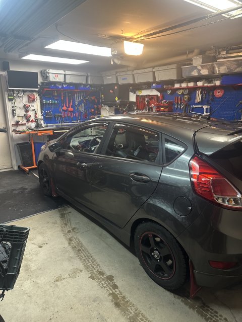

I finally got my garage cleaned up enough to fit my car.
Now that I have a space to work, I’m finally ticking thing off the to-do list.

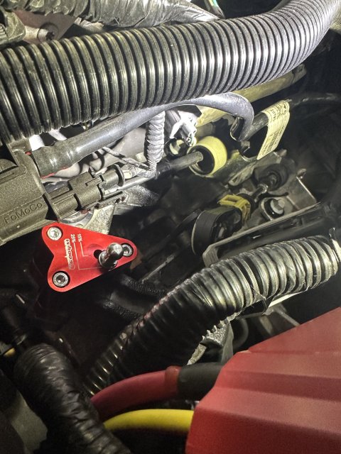

last night I got a whoosh short shifter adapter with solid bushings, likewise reverse lockout, and a redline leather shift boot.

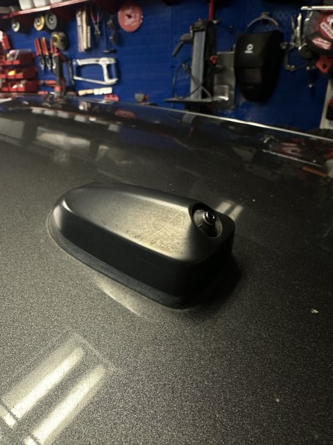

I also did an antenna “delete” not sure if it’s going to stay exactly like that. I may print a flange to cover it a bit more. For those interested it’s an m5 three and I used a Brake lever bleed screw from a SRAM mountain bike brake. Extra nice, because it’s a exactly the right length, and is designed with an o-ring flange.

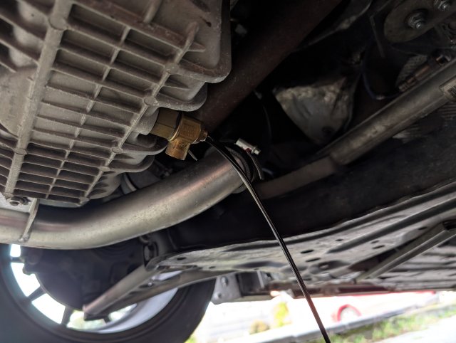

I’ve been thinking about installing a fumoto. I did some research and found some YouTube videos that said you need an adapter. Not sure if you tried that. I’ve got the parts here and I’ll try installing them in my next oil change. I took a screenshot of what they installed on the YouTube video. Looks like it worked well for them.
