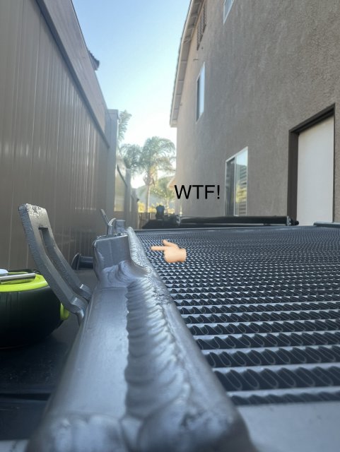

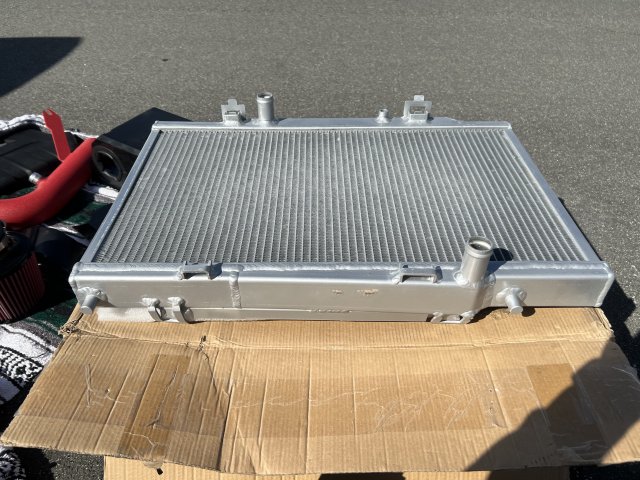

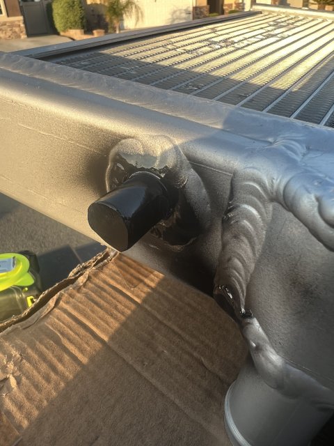

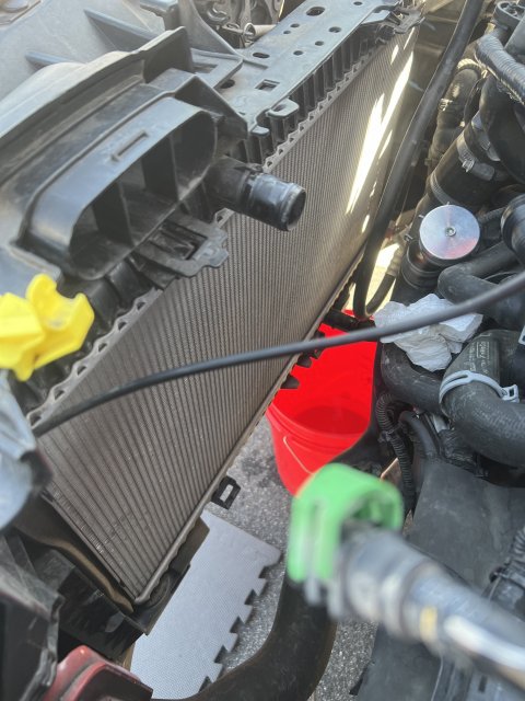

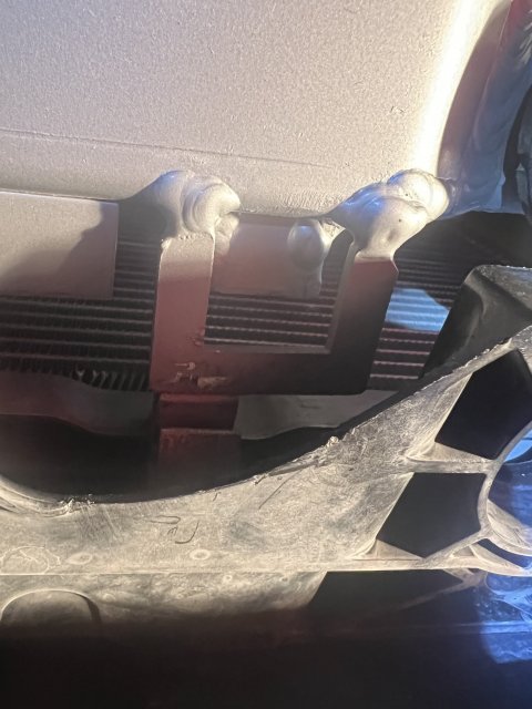

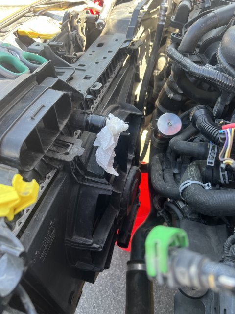

Was flying on a radiator swap. Was feeling good as I was starting to install the new one only a lil after an hour in. Ran into some poor fitment. Bought a “whoosh radiator” second hand on FB. Looks the part but looking at it closer today I noticed the tabs are just wonky. So who knows. I tried everything I could to get it to fit. Hoursssss! Couldn’t get it to swing into the condenser properly, or back into the original mounting points at the bottom. Finally gave up and gunna have to take a grinder to it. That or carefully to the condenser 🥴 If you’ve got insight on whoosh radiator installs LMK please.

Looks to me from your 4th picture dont quote me on this or make me responsible for your radiator if a weld cracks or it leaks but if you took an adjustable wrench and carefully bent the brackets to line up with the bottom mounting points the rest of it should fall into place without breaking out the grinder. Could be more going on here though then just that.

Yea I learned a valuable lesson. Taking a ride share to work today. I’ll be saving the wrenching for the weekend now.
That’s an idea. The squared hollow pieces didn’t want to receive the pointed nipple chingus-es on the bottom of the condenser. Maybe if I tweak that bottom peg with a wrench I’ll go.

It should be "chingaderas" instead of "chingus-es" :p

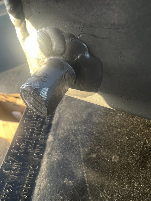

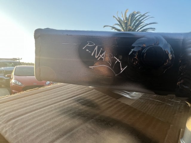

Whoosh radiator take #2.
I contacted the seller. He provided a receipt, so it is in fact a whoosh. ✅
I noticed one of the square tabs was very wonky. Bent it up, hoping that will be enough for that section. Bent some other sections. After cross referencing the Oem radiator, I found that the bottom pegs were a 1/4” inch closer than the original. Took a grinder to make clearance on the inside edges and smidge on the ends. 🤞🏼

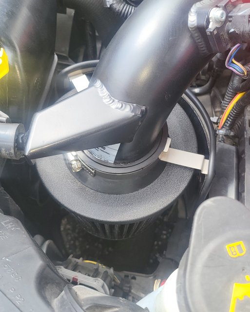

Still working on my intake, so I added the Velossa Tech Big Mouth. Driving around normal temps can range from 4-8 degrees ambient with the stock air box snorkel asks now the big mouth, noticeable improvement in air temps. Plus when on the stock airbox I would consistently see 178-181 Hp on the accessport hp estimate gauge, now I have seen up to 194.9 hp on the first morning pull after everything is warmed up. After driving around with hi temps on the intake I'm still getting at least 180-185ish. So helps imo. And sounds insane lol

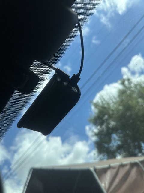

Installed a Focuway dash cam. It came with a rear cam as well and was really easy to install. There was already a hardwire installed from the previous owner but I couldn’t use this dash cam as the usb port was different. Took it off and just used the cigarette lighter port. Ran the wires on the side of the center console, up the glove box, and up the passenger side trim up to the dash cam. The rear one I ran the wire where the washer fluid tube comes out of, down to the headliner and down the passenger side. Took about an hour for both. B1EC4B85-1B20-42D8-A290-81A36D6C4F51.jpeg E05A5D3F-A0F2-46CC-B801-3CA75B909A7B.jpeg D189D06C-8CDA-4863-9560-8B464E1BCB7F.jpeg CCBECB8B-FB5C-4DEE-94F2-B9A73A566D5C.jpeg

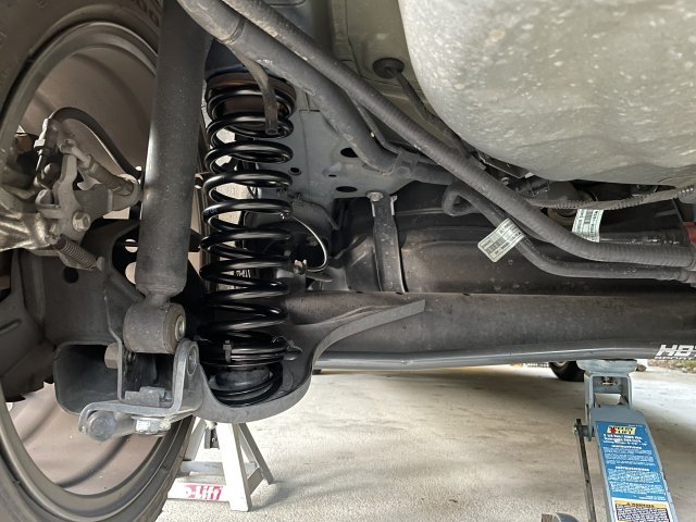

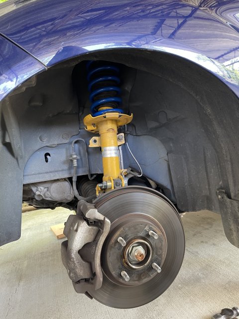

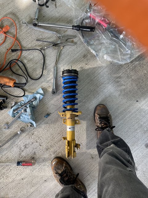

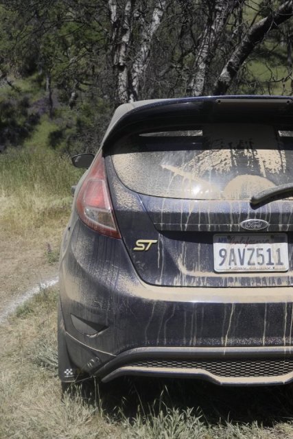

Custom spring experiment with 225F/200R spring rates at stock ride height (on stock/B6 struts) Also, getting nice and dirty!
Made a longer writeup post about it and also finally had an excuse to sit down a make a build post
