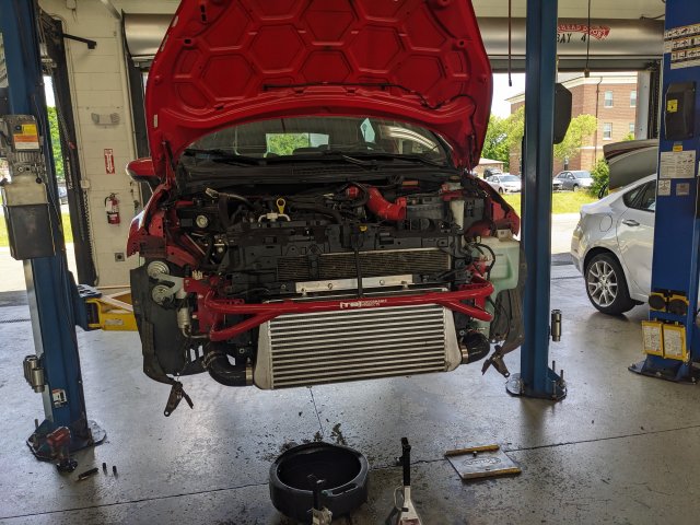

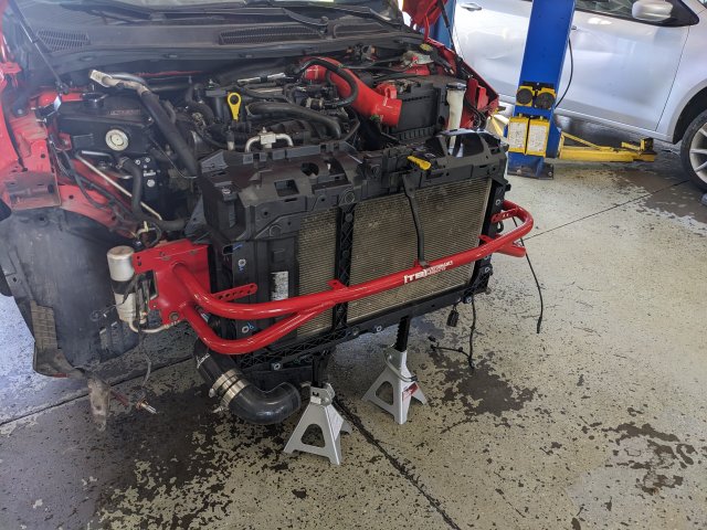

One of my biggest jobs yet. Did my Koyo radiator, new core support, TB crash bar and Whoosh cold side charge pipe. The cooling system was finicky to burp and I almost overheated my engine trying to burp it but now it's functioning perfectly fine. Short drive to the gas station and never saw coolant go beyond 197 and it's 80 outside.

^^^Did the mounting tabs all line up perfectly on the Kyorad?
When I get an aftermarket radiator, this is the one I want, but I wish I knew that it is even a (split) hair better (i.e.; more efficient, especially at idle in the heat) than the Mountune, or not.

It was finicky to get them to line up but everything went in place perfectly. I had a Koyo on my Honda and can't say enough positive things about it. This one seems to be working really good in 80 plus temps. You can't go wrong with this radiator.

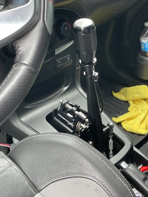

Forgot the obligatory image on previous post. In any case, decided had been putting off on getting the Coolerworks short shifter. Had tried it on my friends Fost a while back and... wow. Finally ordered from Ron, which technically half counts towards this thread, no?

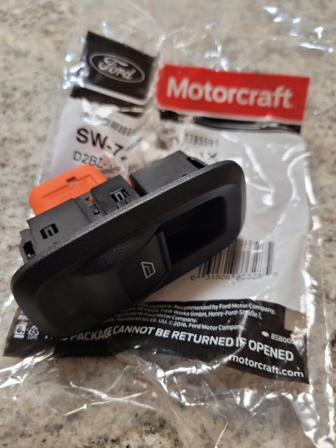

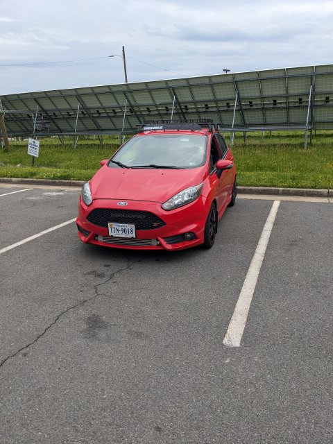

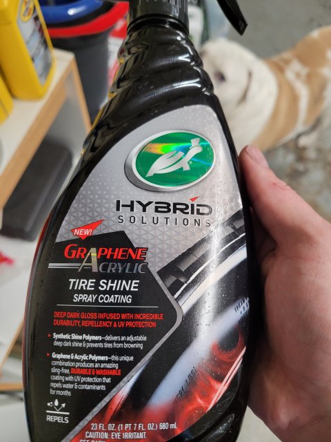

Washed it. Trying out some new Turtle wax graphene tire dressing. Also changed out the passenger side window switch. Up was not working intermittently from that side only.
*idle drop is gone as well, reset KAM on way home today

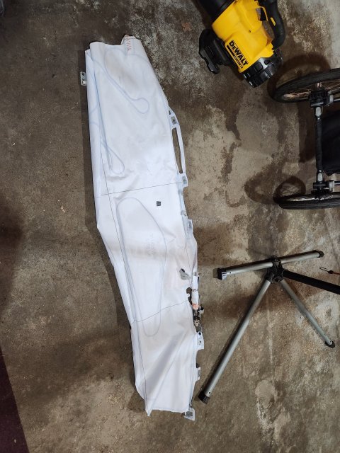

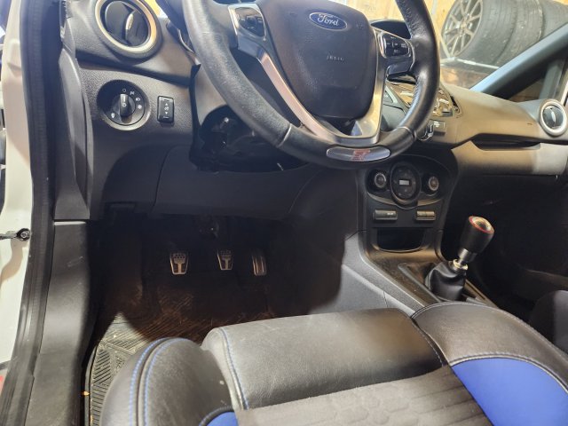

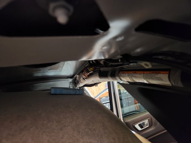

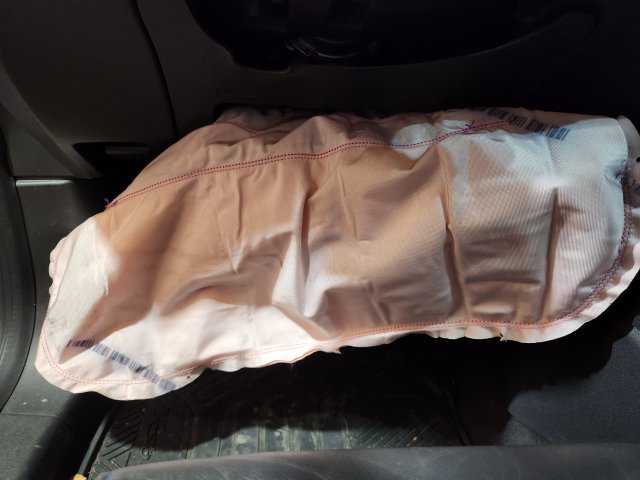

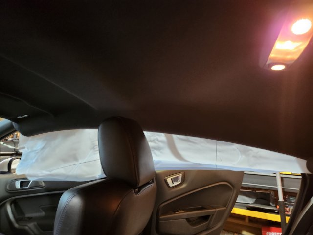

Finally got some time to start repairing the poor fist. Figured I'd replace the air bags that popped first. Drivers steering wheel was quick. The lower bag was a pain because the mounting nut closest to the gas pedal was not a straight shot. I used a watching wrench, and then the nut was far enough off that I could use a swivel shallow socket to get it the rest of the way off. The side airbag wasn't too bad. I just took my time making sure I got it in exactly like the old bag. Unfortunately my headliner has a crease, but I think at this point I'll just learn to live with it.

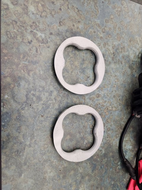

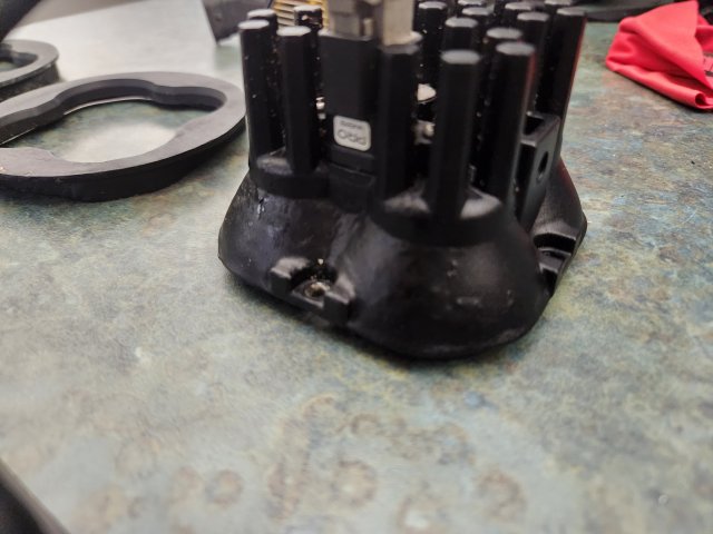

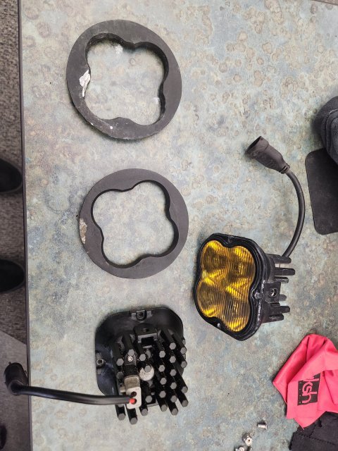

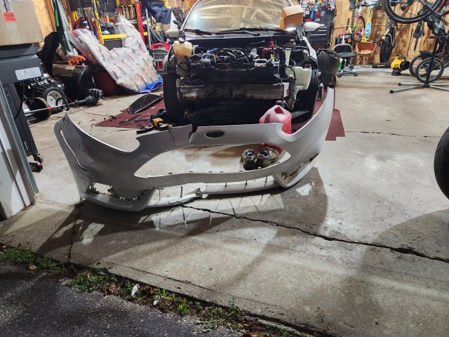

Started pulling some stuff off the front of the car too, I'm surprised my diode dynamics were starting to corrode. (Three years with winters) Unfortunately not a warranty item so I started sandblasting the housing. I don't know if I'm going to unsolder the board to remove the electronics from the heatsink or not yet. I may wait until the corrosion gets worse on that part. Will get those powder coated in my next batch of things. I took off small parts/trim off my bumper to swap onto my new bumper. Need to finish unbolting and get a finalized list of parts I need to order.
#12462
2,701
3,167
Man that winter slush is a killer

Installed yesterday later in the afternoon when it arrived. Dialed it in today.
Still debating if it was worth it after happening on install thread discussion in transmission section after the fact...

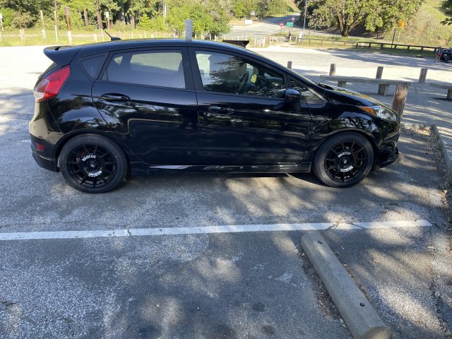

This car eats front tires. Put 2 new all season PSS on the front last august and I’m already down to the inside wear bars, the rears have been on there for over a year and have tons of tread left.
Just got them rotated and rebalanced.
