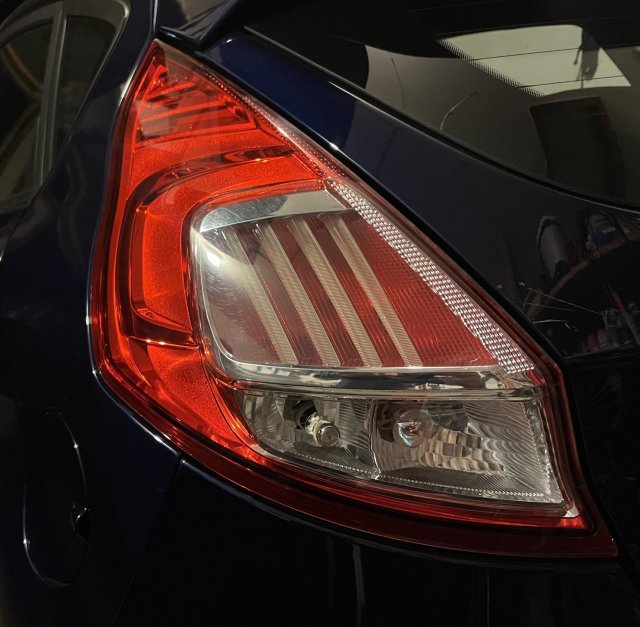

I found a pair of Euro market OE tail lights on eBay from a UK salvage for $145 shipped.
They included the bulbs. The red lights are LED, the reverse light is the same 921 bulb as our USDM tail lights, and the amber signal is a PY21W just like the Euro projector headlamps use. I swapped out the reverse light for an LED and the amber blinker is an Osram Diadem Chrome bulb.

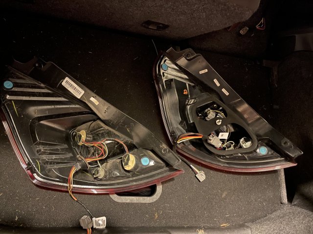

The connector on the Euro assembly is a Yazaki 6-pin male, but our USDM assemblies use the female version of the same plug. I built a conversion harness so I could switch back to stock if I ever wanted or needed to. The connector kits can be found on AliExpress for a few bucks.
Other differences include the US wiring harness with an integrated molded-on rubber grommet.
The Euro tails have a foam gasket of sorts that surrounds the entire assembly. There is also a threaded peg in the center of the Euro assembly that looks like it is used to secure it to the body via a plastic thumb screw.

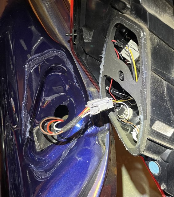

The whole thing can just be unscrewed from the housing.
I slathered on the dialetric grease to help mate the foam gasket to the body to prevent that now-exposed wire opening from water intrusion, but judging by the imprint on the body I think I need to come back with some additional weatherstripping and/or some RTV to seal off the area.

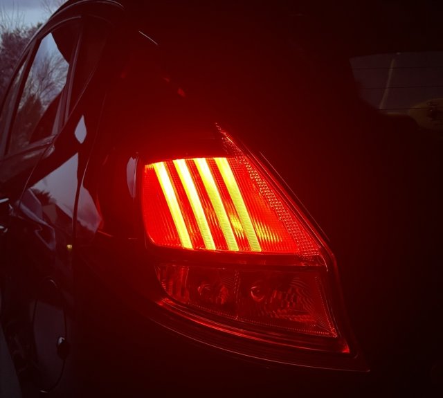

Here's what the running lights look like in the dark:

Now that the wire hole is wide open, I have to protect the whole area with the Euro tail gasket plus whatever it takes to create a good seal against the bodywork. The wire hole grommet is molded onto the OE light wire harness, so I can't transfer it over.
I could buy two copies of the harness just for the grommet and cut off the ends, but that seems like a waste. I could cut it off my OE lights, but I want to retain them in case I want or need to swap them back on. I'm going to get some silicone RTV and some adhesive weatherstripping to see if I can get it to create a water-tight perimeter that makes both the exposed wire hole and the tape a moot point.
I'm open to suggestions on DIY adhesive hole sealing techniques that can accommodate the wires passing through, though.
