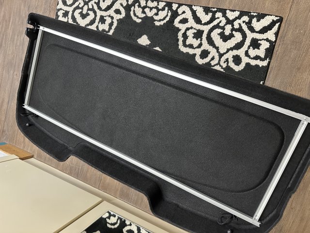

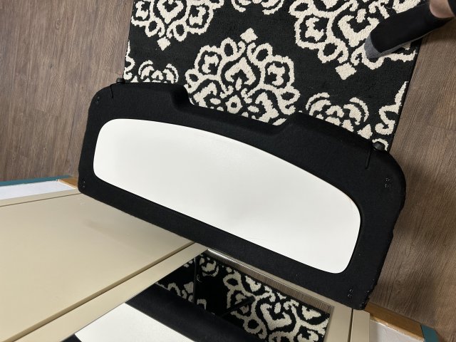

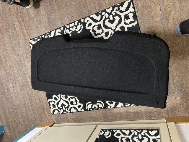

Got a new trunk cover from Amazon. Decided to make a good support for it BEFORE it started to sag like my previous one. Instead of only 1 support I made it across all corners then riveted in place. I also took the time to do what Jeff did a while back and make a removable sticker board that's not yet painted. Debating if I should do a gloss black or matte on it..:unsure:

How much did the cover run you? Mine has been missing since purchase😢

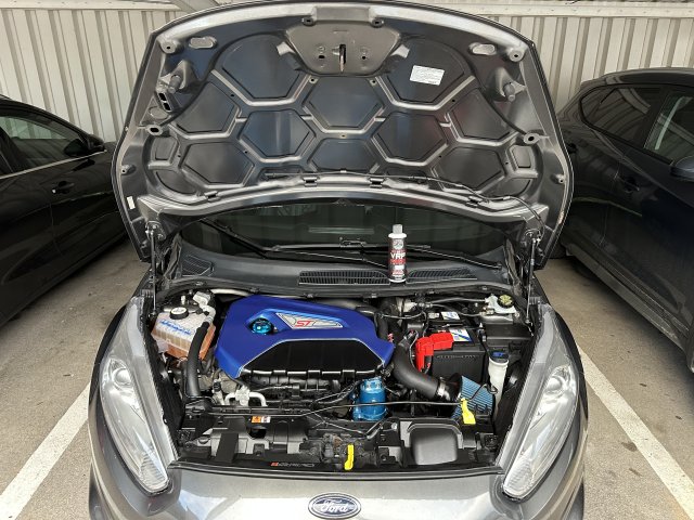

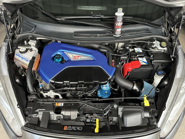

Well... I was going to use this for a tomorrow post but since we got evening thunderstorms I couldn't detail the car before my cruise of Bavaria in the morning. So in the meantime I just did a quick once over of the engine bay. Never used it before and have heard mixed reviews of Chemical Guys products but this VRP works great! Just as good as Mothers Back to Black. I know its not seen much and will inevitably get dirty but, something about a clean and sparkling engine bay looking so fresh just makes me smile.

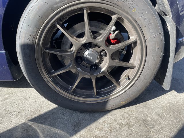

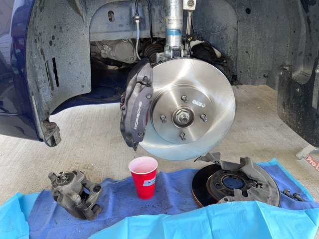

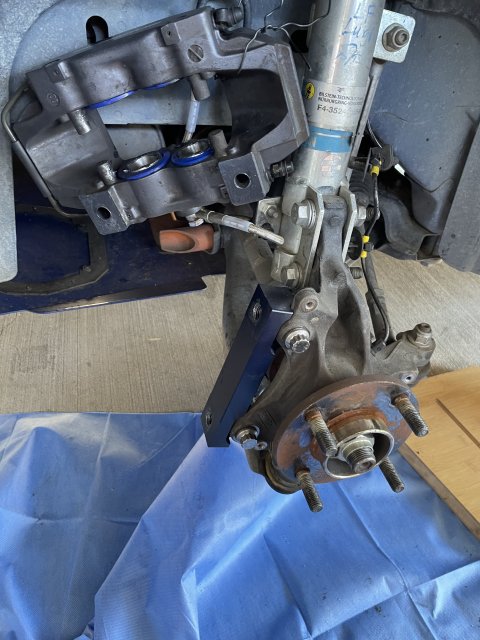

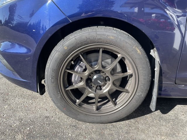

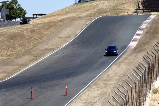

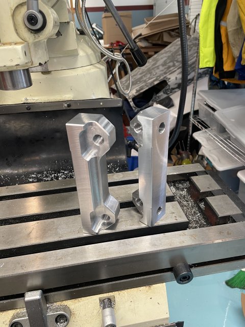

Finished my own custom front big brake kit using bolt-on 300mm SVT Focus rotors paired with 986 Boxster 4-pot calipers on a bracket I made. Tested them out at a trackday last week and they made a big difference over the fading stock brakes + pads. Paired up with SVT rear brackets and 280mm rotors
Wheels are 16x8 ET42 Dekagrams - they fit just right without spacers.
More detailed writeup about the process here if you’re curious how it was done:
https://www.fiestastforum.com/threads/feisty-the-family-car.30825/page-10#post-522405

Where did you source the calipers? I've been wondering if the 986 would fit like the megane, I'm glad to see they do cause the Renault are getting hard to find...
Dialcaliper
1,100
1,767
San Francisco Bay Area
Just got them used off eBay, cleaned them up and rebuilt them with new seals
The 986 calipers have 130mm hole spacing (radial mount) and the mount hole to rotor centerline is about 52mm if I’m looking at my notes correctly
