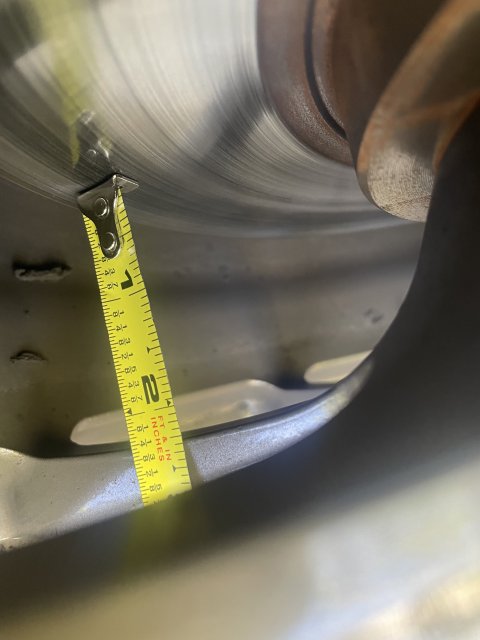

Don’t have my stock wheels anymore to measure, but I can tell you that you need at least about 2.25” spoke clearance measured out from the rotor to clear the spokes, which is the clearance on the Dekagrams. The SVT rotors sit at the same outer depth as the stock ones
However, I feel like the ticket for the stock 17” wheels would probably be to pair some 324x28mm Mk1 Focus RS rotors from the UK (Pumaspeed or EBay) with some C4/Cobra reman PBR calipers (the 2x38mm piston version). They are 2-pot calipers that might possibly fit with no spacers at all.
If multiple people were interested and felt like discussing it, I wouldn’t be opposed to putting in some prototyping on my off time. I’m just not prepared to front the money for the rotors, calipers and pads that I wouldn’t be using. For perspective we’re talking ~$100 per caliper from Rockauto and ~$200 for a pair of rotors from Pumaspeed. Probably $500 at the end of the day including shipping. (About the same cost as the used Boxster calipers).
It would also require several months of patience while I work out the details on my scant free-time (I have a busy day job and a family). It would make it easier if it were someone Bay Area local that had stock wheels to fit check, and again, infinite patience.
The setup I just made on the other hand, which could fit a number of aftermarket 16” and maybe even a few 15” wheels I could probably have something in a couple months with at least a few people interested.

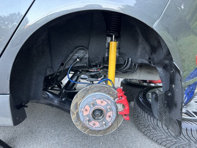

Just finished doing a rust prevention and added some black underbody spray to help keep it down. Also got new wheel well liners since my old ones sagged and then ripped over time. I tried to make them a little more sturdier and possibly will also help with road noise (very minimal at best) by lining each one with a couple cans of rubber spray followed with a couple coats of truck bed liner to protect the rubber and make it more ridged. Overall I'm very satisfied with the outcome and wish I did something like this years ago to help protect the car from the elements. A couple years of winter in Colorado Springs did a lot more wear than I would have liked.
Not the best pic as a few touchup spots were still wet after using the last little bits in the can.
