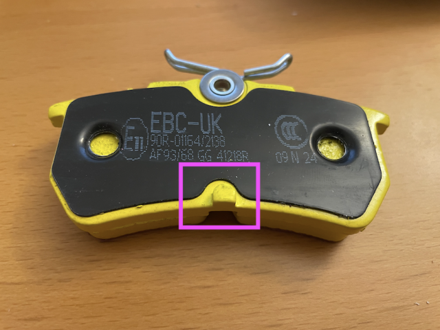

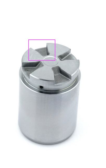

I got the EBC redstuff pads and there is no grove on them like the OEM. Just flat backing plates on all 4 pads. I don't believe that should cause an issue as all 3 other brakes work fine with no drag.
I believe he's talking about the knob on the edge of the back of the pad that needs to go into one of these grooves on the piston. Here's an EBC yellow pad I have but red should be similar. I was in the same situation; one side was randomly aligned but another one wasn't.
View attachment 68074 View attachment 68076
I did not notice if I have those or not, thanks. I probably just fixed the squeak then by accidentally reversing the pads into the correct positions since I thought both sides were identical.
I have Blue NDX at home in the Box ill open and check tomorrow* I'm 99% sure The EBC Yellow i used to Run and the EBC Blue NDX i run now have them on the pads.
This X 100*
