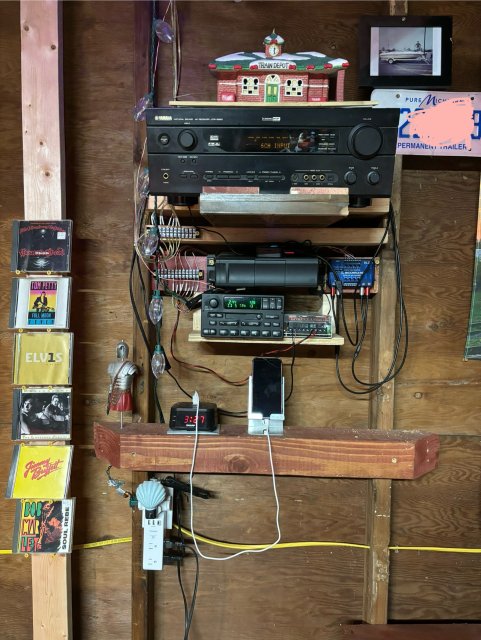

Maybe I need to hit the bong to understand what the hell I'm looking at here lol
Yes, an old home theater stereo (6 input capable) with handmade corner speakers off marketplace for 100 bucks. One of the inputs is the car stereo from a 2002 f150 with the 6 disc changer out of the backseat too. Current CD lineup on the left. The blue box converts those speaker level inputs into rca inputs connected to the Yamaha unit. Car stereo powered off a 12v transformer on one of the 120v Yamaha switches outlets. Also have Bluetooth on another input, with room for a tv, record player, etc etc on the other 4 available inputs.

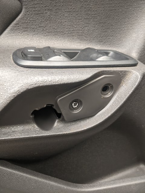

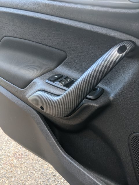

Same thing happened to me. I bought a new door card rather than try to glue it back.
Probably what I should have done. Instead I jerry rigged these things I got off Amazon. PXL_20251015_204401938.MP.jpg
The door panel has a pad with two additional attachment points for the factory handle that is not accounted for in the one piece handles I bought so they don't fit flush. I had to buy some longer screws and stack a bunch of washers on the top screw to keep them from twisting. PXL_20251015_202839991.jpg
It seems like those two extra plugs are one time install cause I'm pretty sure I broke them taking off the passenger side handle. Probably why Ford just replaced the whole panel.

Probably what I should have done. Instead I jerry rigged these things I got off Amazon. View attachment 68174
The door panel has a pad with two additional attachment points for the factory handle that is not accounted for in the one piece handles I bought so they don't fit flush. I had to buy some longer screws and stack a bunch of washers on the top screw to keep them from twisting. View attachment 68175
I have the same handle on the drivers side b/c my cover wouldn’t stay on. I just switched the long and short screws and drilled the one hole to further countersink the short screw to get it to work.

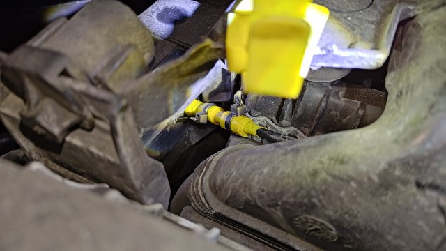

That hood release line was worse than I thought; rubbing against some metal framing on the radiator.
My stock vehicle has less than 80k. One day folks are going to start discovering that they cannot open their hood.
Click the thumbnail image to fill screen; then double-click to bring image to original size.
