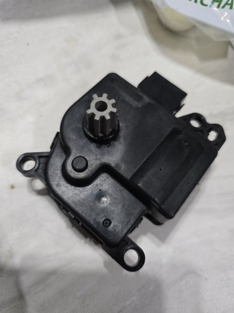

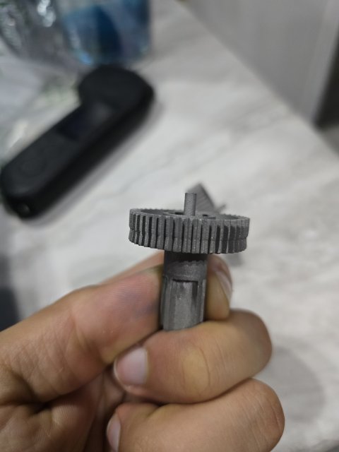

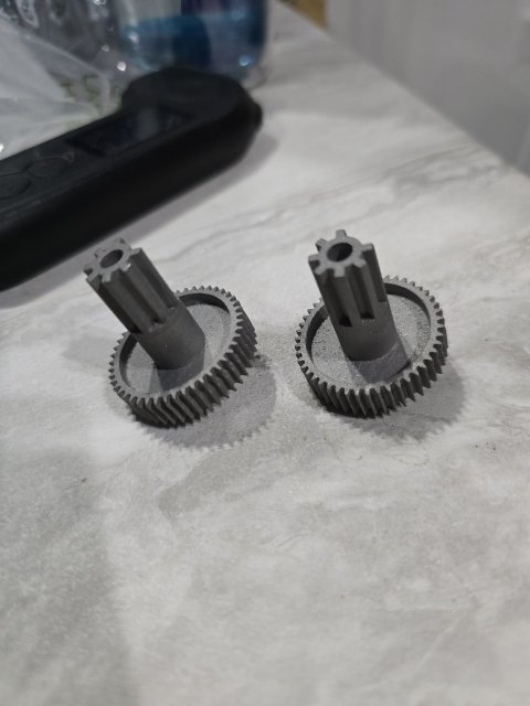

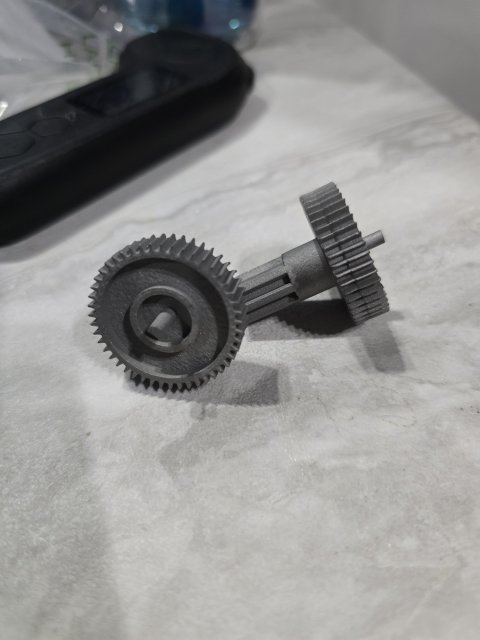

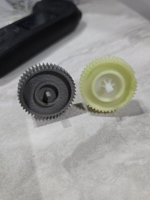

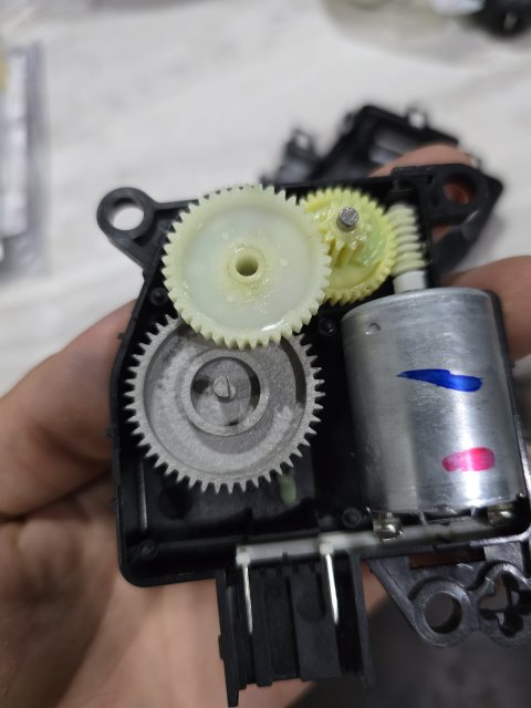

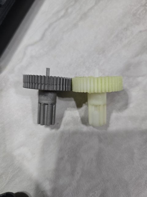

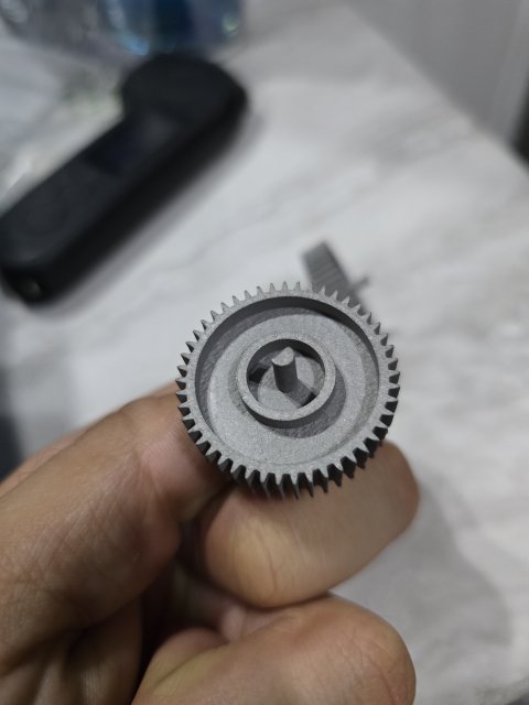

Got a gear ordered from JLCPCB.com. Took a month to arrive but the communication was good and the product arrived very very well packaged and it only cost me 7$ for two gears, as a new customer. It's aluminum. If the other plastic gears end up breaking I'll get them printed in aluminum as well.

Our whole HVAC system/setup is soooo effing screwed up, I expect that even those alloy gears will break and/or strip, eventually.
WHY TF Ford (and every other manufacturer for that matter, even the supposedly 'infallibly perfect' ones!) could not have just gone with old school, simple HVAC controls, and INSIST on making things MUCH more complicated and unreliable as possible is perplexing (at least before the whole car warranty has expired). :mad::mad:
271
220
Houston, TX
I never understood it either. I'm really hoping the metal gears solve the issue. I'll have to report back if they ever break
Wow! Do you have an order number or some other piece of information that can identify your order. I kept my old old unit and I might try replacing the gear for when the next time the current unit goes out.
271
220
Houston, TX
Not sure if they can pull up the model from my order number but here it is W2025081903355746. I got the gear model from thingiverse, there's lots of you search. If the other gears end up breaking I'll have them printed but so far so good 200 miles later
