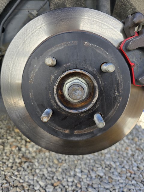

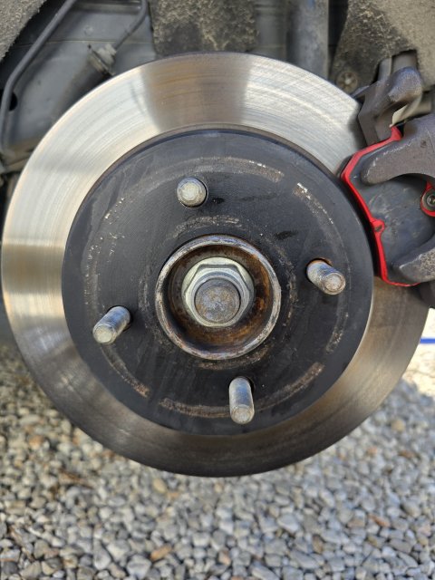

Trying to figure out why my rear driver brake is braking unevenly. You can see in the pics the black area is where my pads aren't contacting and the cleaner area is where it's grabbing with no brakes applied. When driving I hear no noises. Under braking I can hear it going squeak squeak so it's definitely only grabbing one part of the rotor and I'm not sure why. Caliper pins are perfect condition and lubed up moving completely freely but once the caliper is on it feels bent or something

That would ordinarily indicate that the rotor is warped.

I guess I'll swap side to side and see if the issue transfers. I just installed the rotors a few hundred miles ago and the issue was there from the start. My previous rotors also had the same issue on the same driver side rear caliper. Maybe my caliper is bad cuz it kinda felt like it didn't wanna rewind all the way back in? I'll have to swap the rotors and go from there. Thanks

Did you clean the hub face? Rust build up can cause uneven wear/seating of the rotor

Did you get the pads in correctly? There is a keyway that needs to line up with the pads in the rear when being serviced. [driving]

I got the EBC redstuff pads and there is no grove on them like the OEM. Just flat backing plates on all 4 pads. I don't believe that should cause an issue as all 3 other brakes work fine with no drag.
