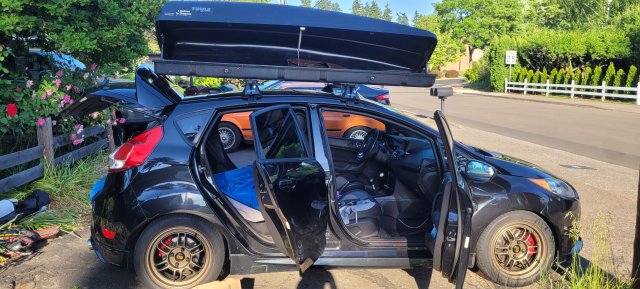

Got it, my dad just got a steal on a Yakima box for their Outback [with the handy built-in rails].
We've got an Expedition Max, so it's unlikely that I'd ever really need the extra storage in the FiST. But good to know.

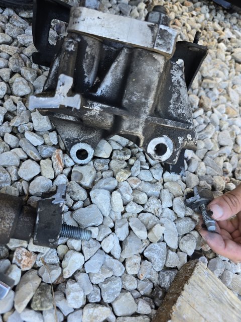

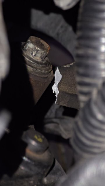

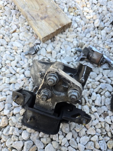

Am I tripping or did I shear my transmission mount? Will update once I got the battery removed 😬. The whole engine jerks and I see my shifter wiggle about an inch and a half during stoping and starting
Are you super hard drag race start launching it on very sticky tires?
TONS of wheel hop if/when you do??
I've never seen or even heard of that happening in these cars in the almost ten years on this forum and nine years of owning a FiST

I've never seen it nor can I find anyone who's had this issue online. It's been raining so I'll get to look at it tomorrow.
I had cobb tc on 4 with cobb stage 2 tune and launched the car from 4k rpms. Drove the car home the remaining 4 miles and didn't notice anything (but I just got off a long shift and was tired ). Turned the car on today and right away noticed the shifter wobbling a shit ton and when I went to drive off CLANK CLANK and all the vibration so I parked and checked.
Car has an LSD and stage 3 clutch with SMF. Stock turbo. Really shocked this happened tbh
What Mount? OEM?

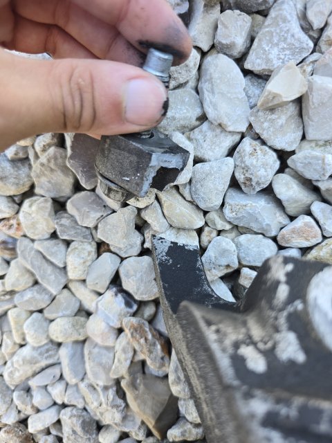

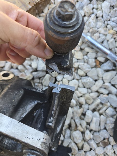

Bent my RMM as well since it dropped. I'll be replacing all mounts with VibraTechnics probably. It appears the failure was due to forgetting one of the 4 bolts? I torqued the 3 bolts to spec and used blue threadlocker. One bolt I know I forgot to put in(as I found it in my pile of bolts), the other bolt must've backed out while driving

My only other guess is I over torqued those two bolts where it snapped. Or maybe since my mounts are shot it had so much movement it snapped

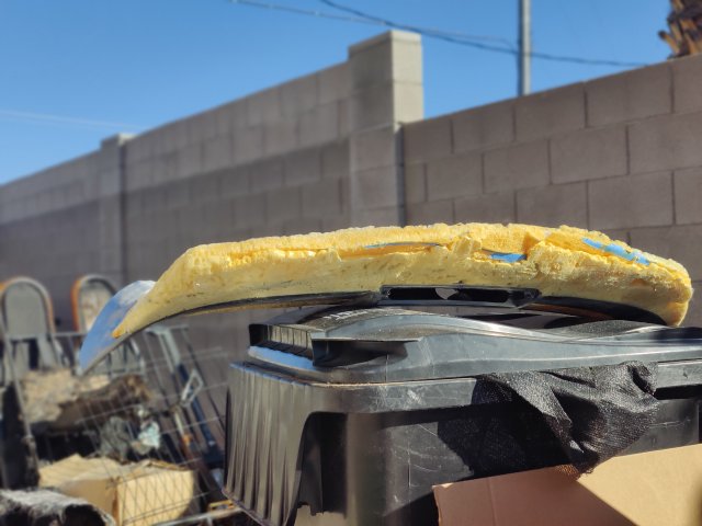

Finally had some time to shape the spoiler, there is a lot of voids so I need to build up some areas before I smooth with bondo and cover in carbon... But I think this is the final shape I think 1000009976.jpg 3a8b4460-1725-4792-8940-23b82fefcb6c-1_all_23786.jpg
