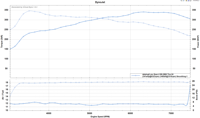

Fueled up for first revision on my E50 tune. Already getting some pretty good numbers at least based on Vdyno.
Just wish there was some easier to get E, I'm having to do E98 and it's not cheap.

VDyno of the first revision.

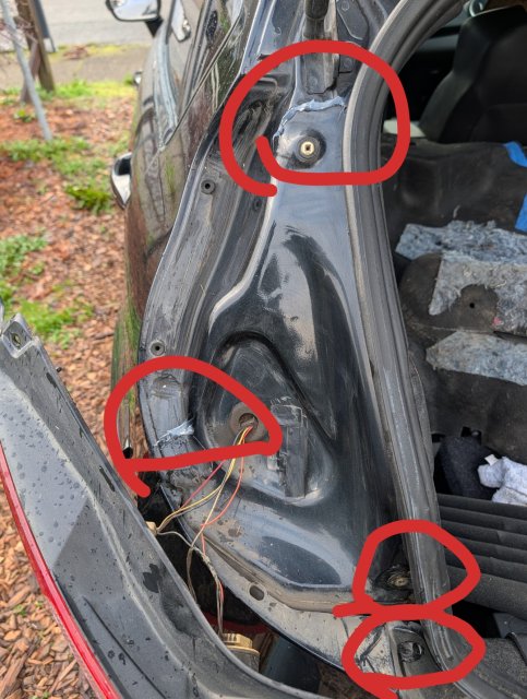

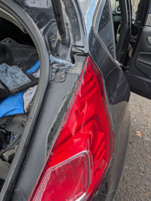

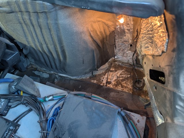

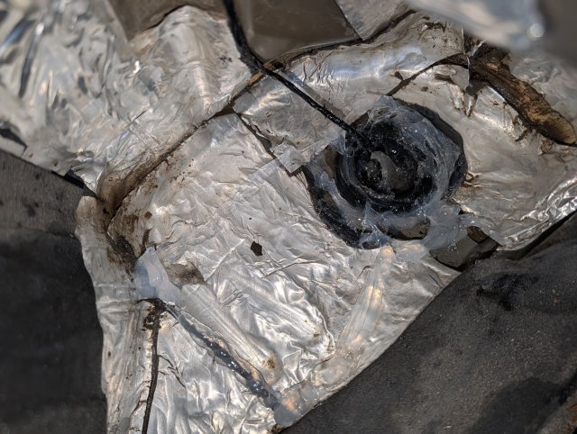

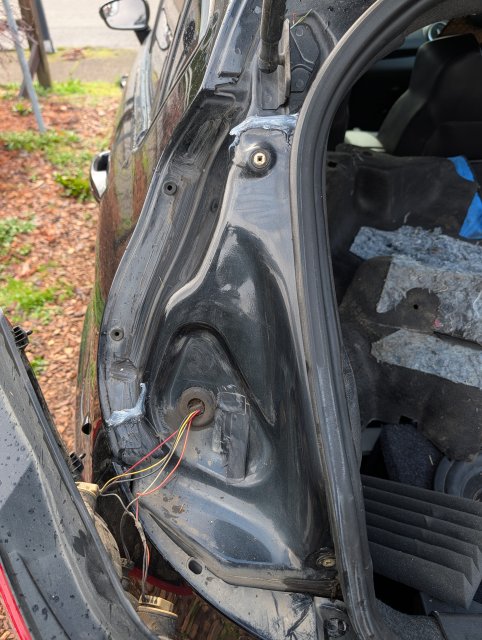

I'm chasing a leak today. It's back by the rear passenger wheel.
I'll just put a bunch of epoxy or silicone down and call it solved. It looks like whoever matted the car didn't leave enough room around this seal and it leaks a tiny bit
I also have a passenger door seal leak that I'm just not gonna deal with. As far as I can tell I'd have to replace the whole strip. I think that's 4 leaks ive had in this car. Weird.
Check under the taillights? I haven't pulled my bumper cover off yet but I was definitely getting water from under the lights.
https://www.fiestastforum.com/threads/water-leak-fixed.23935/

I just went nuts with the silicone. Will it work? Who knows.
I tried to create a route so the water will go down the side. I also put silicone in all the fastener holes and just about anything I could find, including behind the lights. I'll have to redo it whenever I change a bulb, I guess.
What a weird design by Ford.
Here's a google photos link with some video. https://photos.app.goo.gl/7vdNt1DJRbkwnt9a7 In case you were wondering, I had foam leftover. I have no idea where they were putting all this foam, lol.

@Cneu - I have a water intrusion (leak) thread...
https://www.fiestastforum.com/threads/water-intrusion-issue-resolved.23553/post-435429
...that will contain the answers to the issues.
Haha thanks. I just went nuts with the silicone so hopefully I got the rear leaks fixed up. I hit most of them that I could think of. I nearly broke my ankle yesterday so I'm not dealing with a bumper today. Luckily my sunroof doesn't leak yet.
Will report back maybe.
We don't know to what degree they did this, but apparently Ford used tape in place of some grommets. Tape is temporary so literally everyone who has the factory tape job will have these leaks.

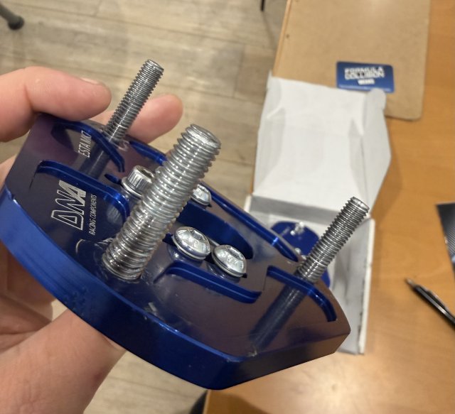

Haven’t been able to hit the track due to alignment limitations while back on OE LCAs w/ caster bushings & OEM top mounts. Pulled the studs out of 3 DNA camber plates, so had a machine shop fix that reoccurring issue.

Does that allen screw and those Torx (or are they an allen pattern as well?) screws stand up to (i.e.; retain settings) hitting/running over the curbing on tracks?
Yes, zero issues. There are threaded slots that they live in & cannot be changed when the strut is installed on the car. Would they hold up to gravel roads at speed? I am bound to find out eventually.
They are not Vorshlag or Tarrett quality, but about what I’ve come to expect from the FiST aftermarket. I have their adjustable LCAs on the way next month & crossing my fingers that I can get 5+ caster finally. That’s what I would need to test the gravel wheels/tires safely, but more importantly, 235+ tires at the track. If not, gonna throw some new ball joints in the non adjustable DNA arms Ive been running for the last year & mod the strut tower. Melted the boots on those arms, but they have noticeably more droop travel vs OEM & a much better BJ.
