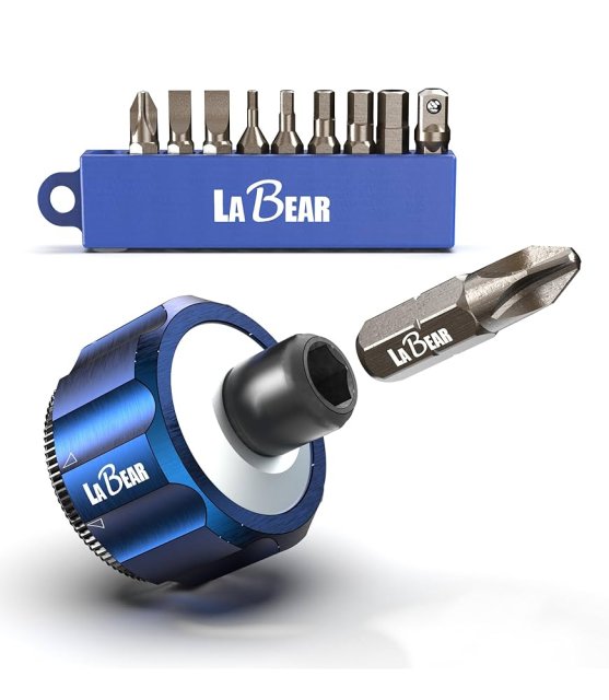

How much of a pain was it to swap?
Not too bad. Took 15-20 min total, ever since I got one of these.
Just remove passenger center console side panel. And between This tool and a screwdriver, take off the 5 Torx screws.
personally that hardest part was getting the new filter in without crushing it too bad.

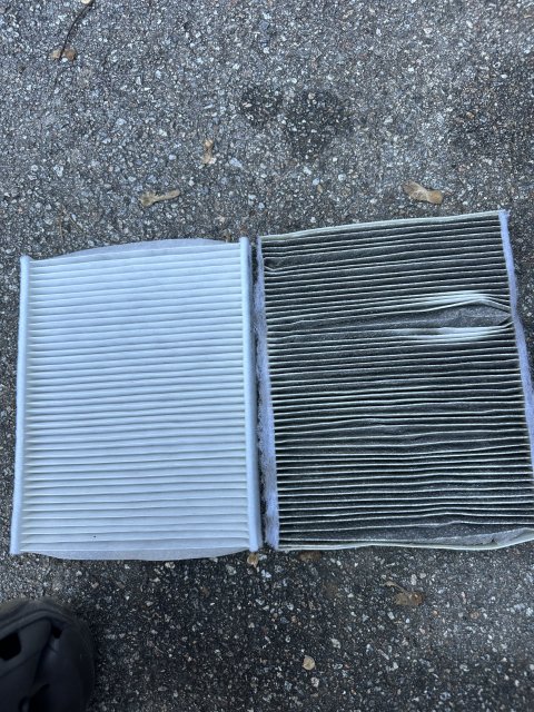

Your annual PSA to change the cabin air filter.
Just changed mine before the snow storm hit. Pretty crazy for not being in a dusty or dirty area and only 11 months old. View attachment 68968
I just did mine the other week. I usually take out the glovebox and the one HVAC tube that is in the way. This time I only put the lower three screws back in to help simplify the process when I do it next time. Five screws to hold in a cabin filter seems like overkill to me.
No leaking with the blower on?

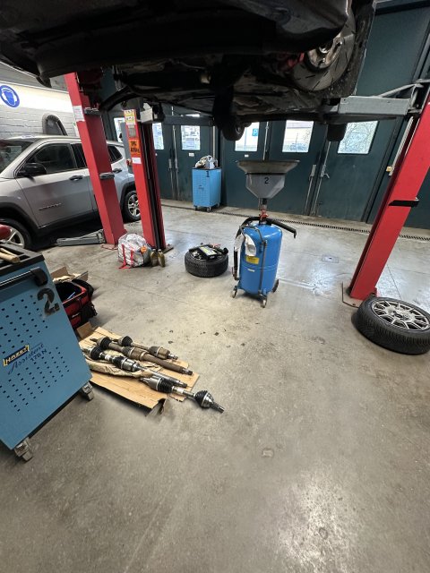

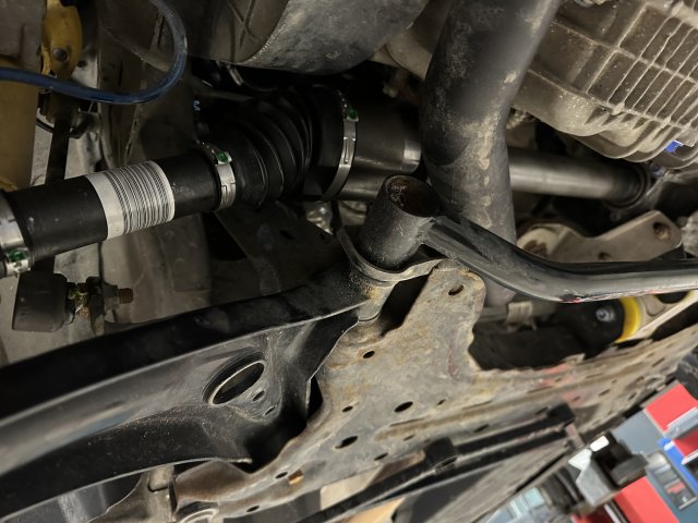

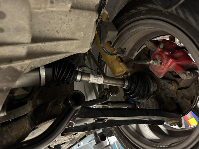

I also forgot to post it, but recently replaced both axles and seals after my driver side started clunking and both seals from my clutch job in June started leaking. Think it was caused by my “helping 2nd set of hands” just thrashing them in while not being flush. These replacements have not leaked once. Tried out some Ravenol MTF 75W-80 this time from Motul Multi DCTM. everything feels great so far. IMG_3402.jpeg IMG_3404.jpeg IMG_3405.jpeg
I've got mine programmed in my maintenance app for annual replacement. The Rabbit gets one every 6 months due to rallycross useage.

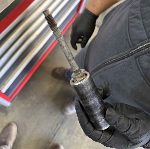

Went to replace the bushing for my AWR RMM, Sucker was seized on there and stripped out when I tried to remove it. Had to take it to a local shop who welded a bolt to get it out for me. Not sure what the heck the previous shop did when I had the motor replaced, but this thing was not coming out under normal means. (Though, it could be bent since I'm pushing a lot of power and am quite hard on the car for autocross)
Replaced the hardware with the Whoosh anodized bolts.
